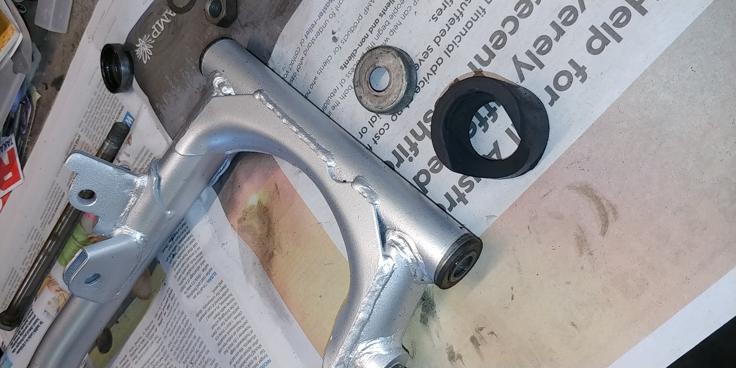

I've just spent an hour or so reshaping this genuine DT175 swingarm protector so it fits the TY250D swingarm. I used an abrasive mounted stone in a high speed pistol drill. Very fiddly work.
The correct part is no longer available.
Does anyone do this a different way?
