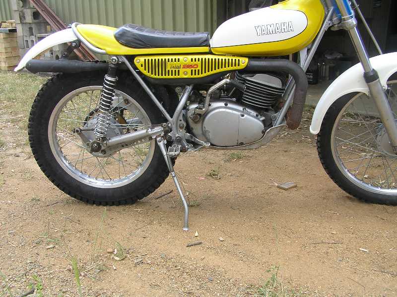

Well my TY 250A side stand (on the frame) has survived quite well considering the amount of crashes I have had. I will leave the side stand on the swing arm for the moment so yes please post the photo.

David thanks for the picture of the sidestand. I have a few more of the basics to sort out on the E but had my first ride on it on the weekend. Yeh they have a nicer motor.
