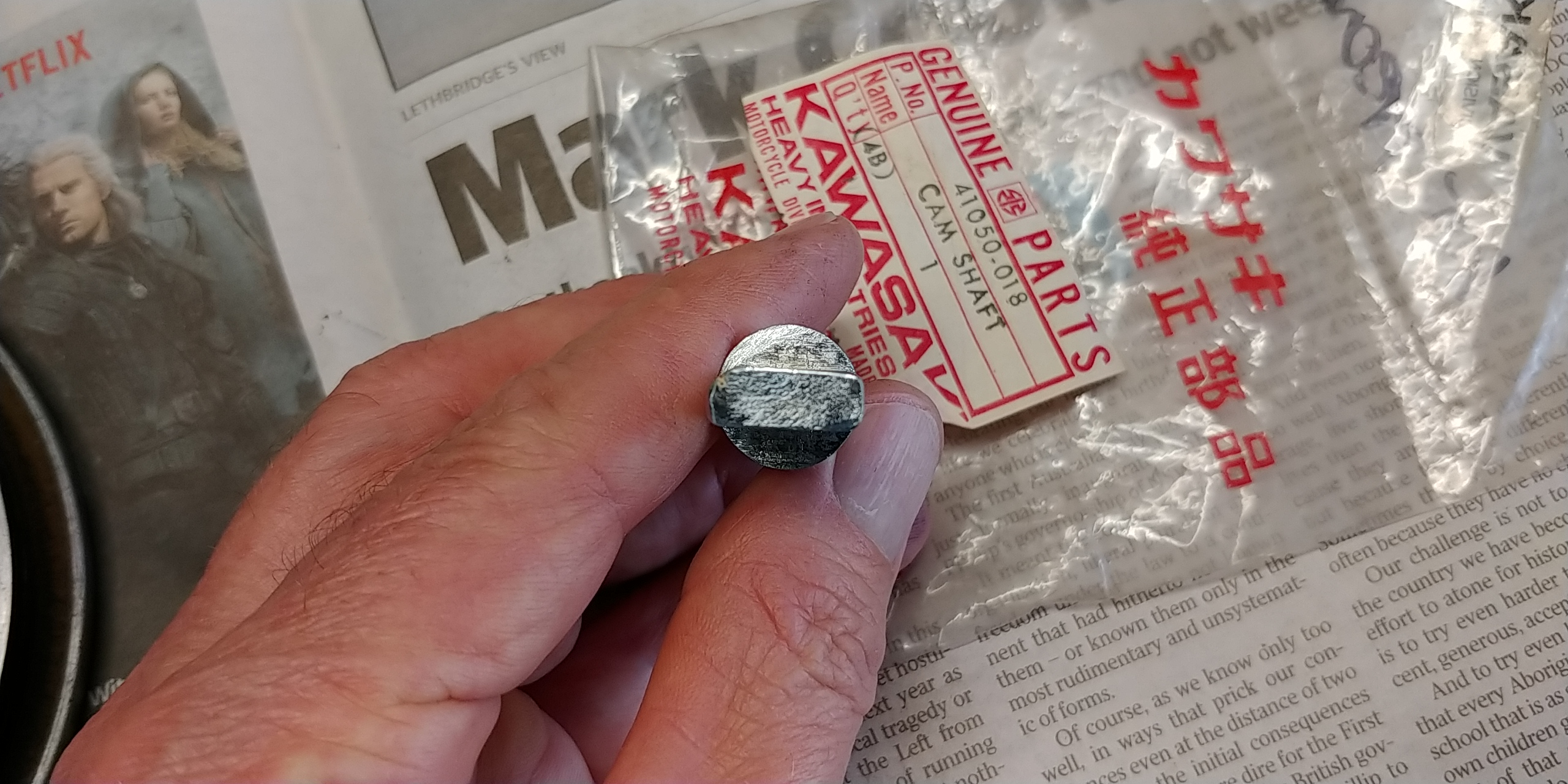

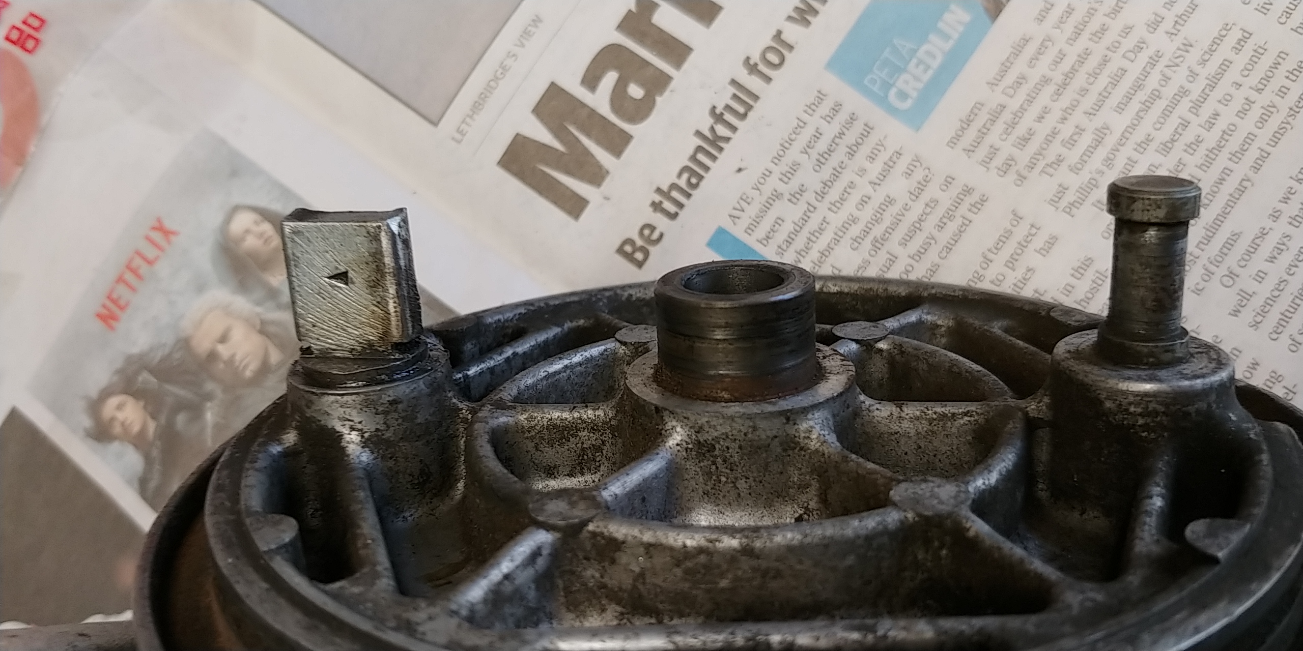

A few weeks ago I'd been servicing the front brakes and noticed that one edge of the brake cam was a different profile to the other edge. At the time I put this down to someone before my ownership reshaping the cam for some unknown reason. I went to my KT parts stash and pulled out another front brake plate and the cam in it, while a bit worn, also had a different profile on one side to the other. Bells did not ring but maybe they should have. I then put the bike back together with the better of the two cams and ordered a new front brake cam NOS from someone in the USA.
The new cam arrived last week and when I took it out of the packet I saw yes, it also had a different profile on one side to the other.
At this point I thought it could have been a manufacturing defect in all three of them, but on looking at one of them I noticed an arrow mark stamped into the cam and this definitely rang a bell :idea: telling me that there is a right way and a wrong way to fit these things.
Now I'm the sort of person who only consults the manual when I can't work something out myself, so today after doing endless mental visualisations of the geometry of the cam and the shoes and which shoe is leading and which is trailing, I actually got the manual out and had a look and in the text there is a one-liner saying to point the cam arrow at the axle =D> and yes I had the thing fitted the wrong way around :roll: .
Mystery sort-of-solved :shock: . Knowing which way is correct does not tell me why they did this thing????? when I don't see it on other bikes. Why is it so????

David, it is always interesting how we sometimes do things the oposite way but usually end up in the same place! Would it be that :kawasaki realized that the brake shoes both pivot at the same point, the fixed end. When you think about it this way when the cam spreads the shoes, the inner actuation side of the cam would push that side shoe out more than outer side of the cam? Therefore to make the movements equal the cams need different profiles.

Yes chocolate is always a good idea, but your answer doesn't fully answer my question.
Why would :kawasaki be the only manufacturer to bother doing such a thing when the same mismatch of shoe travel applies to every manufacturer who has made a single-leading-shoe brake?
