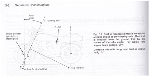

Before we leave trail, it’s worth noting that what we call trail (measured along the ground) is not real trail. It’s more accurately called ground trail & is what we are familiar with because that’s what manufacturers quote for “trail”.
But real trail is measured perpendicular to the steering axis (Fig 3.2), not along the ground, for that is the true ‘lever arm’ upon which the self-centring torque acts. (Sometimes it is called normal trail, where “normal” means perpendicular rather than “usual” or “common”, but to save confusion we’ll use the term real trail.)
This may not sound like a significant distinction, but real trail is more useful when comparing trail figures at different rakes (see below). If we consider real trail, say of 70mm, it has the same self-centring effect at any rake. But if we just consider ground trail we need more of it with increased rake to have the same self-centring effect. (NB. I am not saying here that we get more ground trail with more rake. We do, but that is a different matter.)
There is a simple trigonometric relationship,between them:
Real trail = ground trail x Cosine of rake angle.

There's some observations on the KT's geometry/handling coming after the RL's.
You can tell a lot about how a bike will handle by looking at the specs & a good side-on view of the bike. The RL's swingarm geometry is one of the things that stands out like the proverbial .....
I did put a brief explanation of its effect at the end of the last paragraph, but your'e right, it was a short-cut. I tho't it was time to move on from the science/maths into some practical applications.
I have edited that last paragraph above (in my last post) to explain it some more, but I'll see if I can find a suitable diagram to post that explains it further/better.
I do remember your experiments with the TY forks on the KT, Dave. The TY forks are quite a bit shorter than the KT's, & I've often wondered how it would have gone with longer stanchions (say off a DT) so that the guard didn't hit on full compression. I might yet try it on mine.
