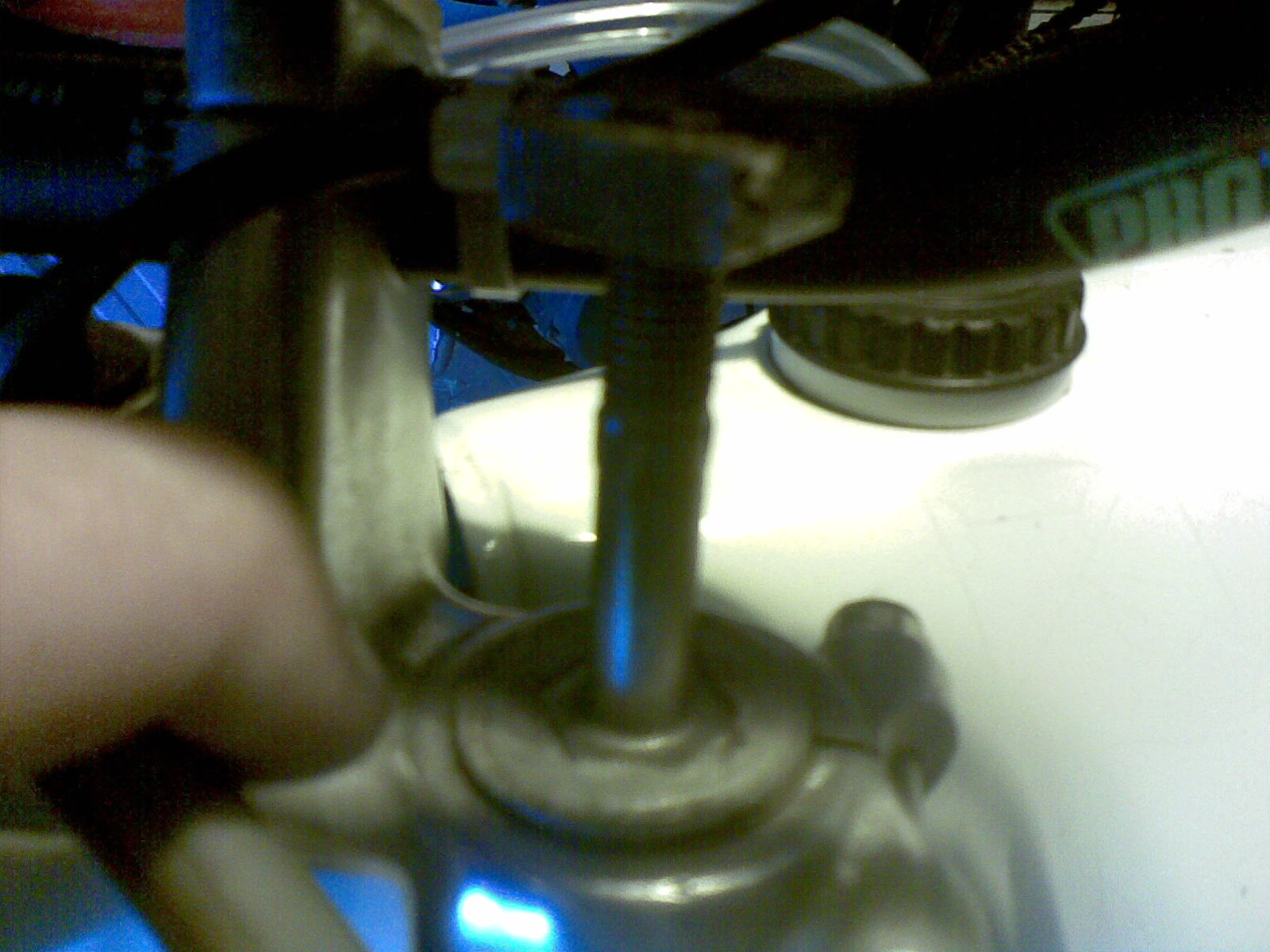

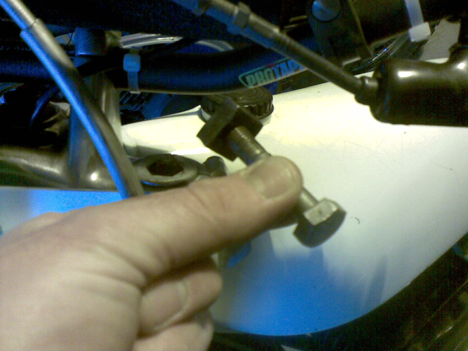

Re: Could someone please walk me through TY250a Fork oil change
No fancy tool required
