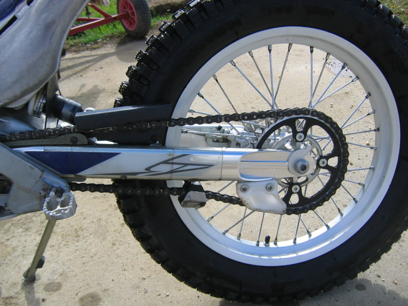

mine is about 15cm forward the rear tire edge.
but hey i just check some pics, which is obviously a scorpa
un accidentally similiar
thats why it feels so good :mrgreen:

I think you need to look at a photo of a trials bikes which has been taken with the camera centreline at 90 degrees to the centreline of the bike and with the footpeg in the middle of the photo. The Scorpa photo you have shown has been taken with the camera rearward of the footpegs and pointing forwards, giving the illusion of the footpegs being more forward than they really are.

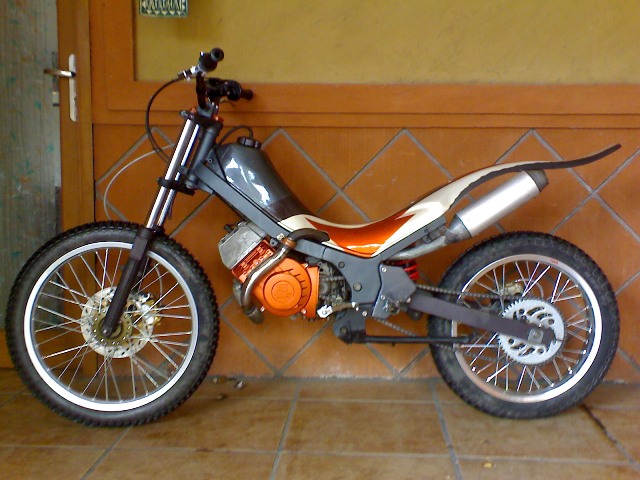

a 18" wheel is=457,2 which is a diameter/2 to get the radius= 228.5 center line to the edge of the rim + tyre thick which is 4"=101.6 mm
so
228,5+101.6= 330,1 (edge of the tyre)
if you said its 420 that mean it short 90mm to the edge of the tyre.
this is scorpa
i need a new frame and arm
