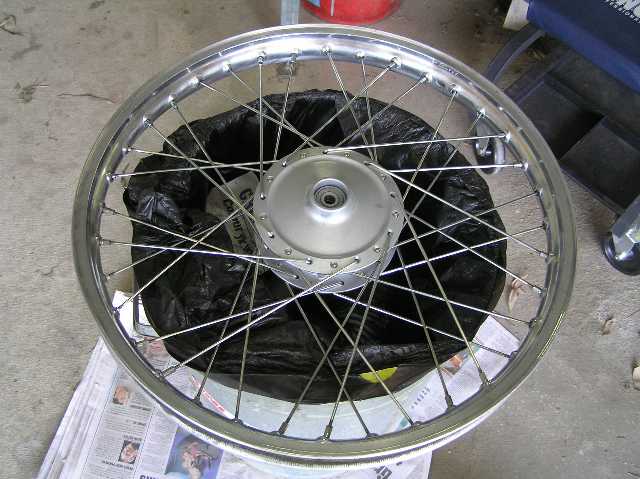

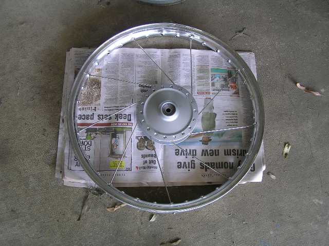

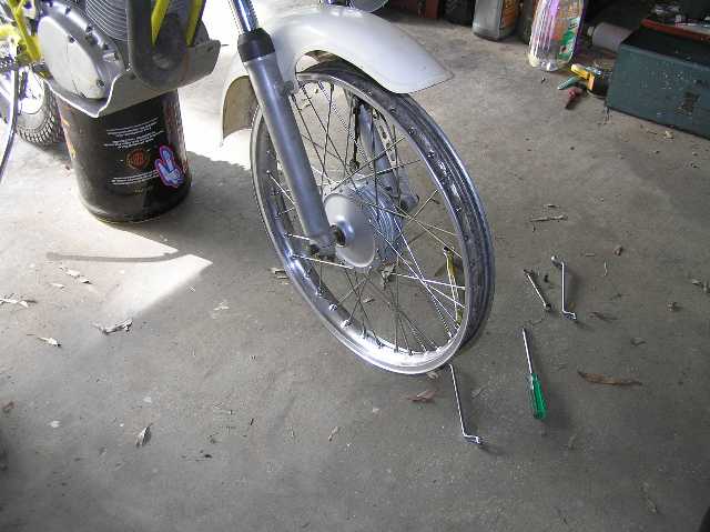

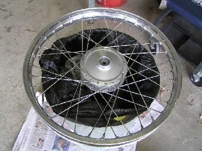

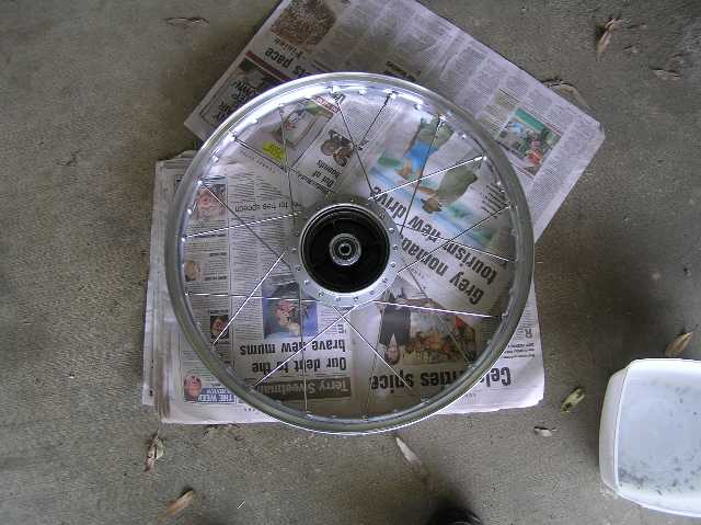

Re: Rebuilding Wheels
Photo sequence showing TY250D front wheel putting the inside spokes in first on both sides then the outside spokes. Some wheels it doesn't matter but with TY wheels you have to do the inside ones first. Last photo has wheel in bike to centralise the rim and get it running true.
