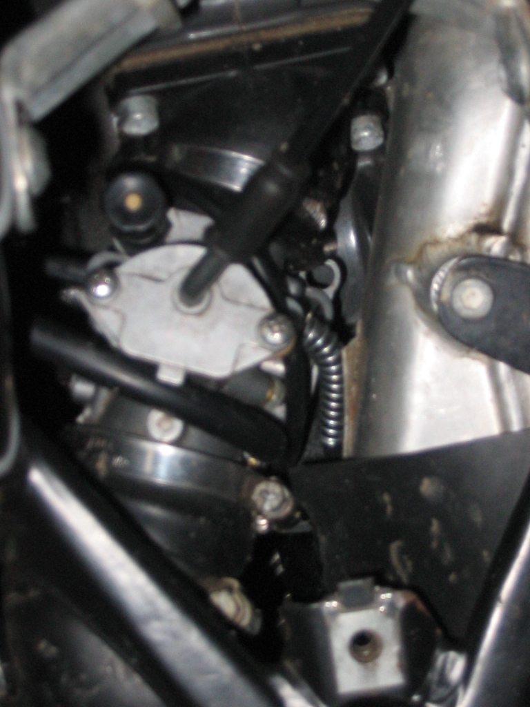

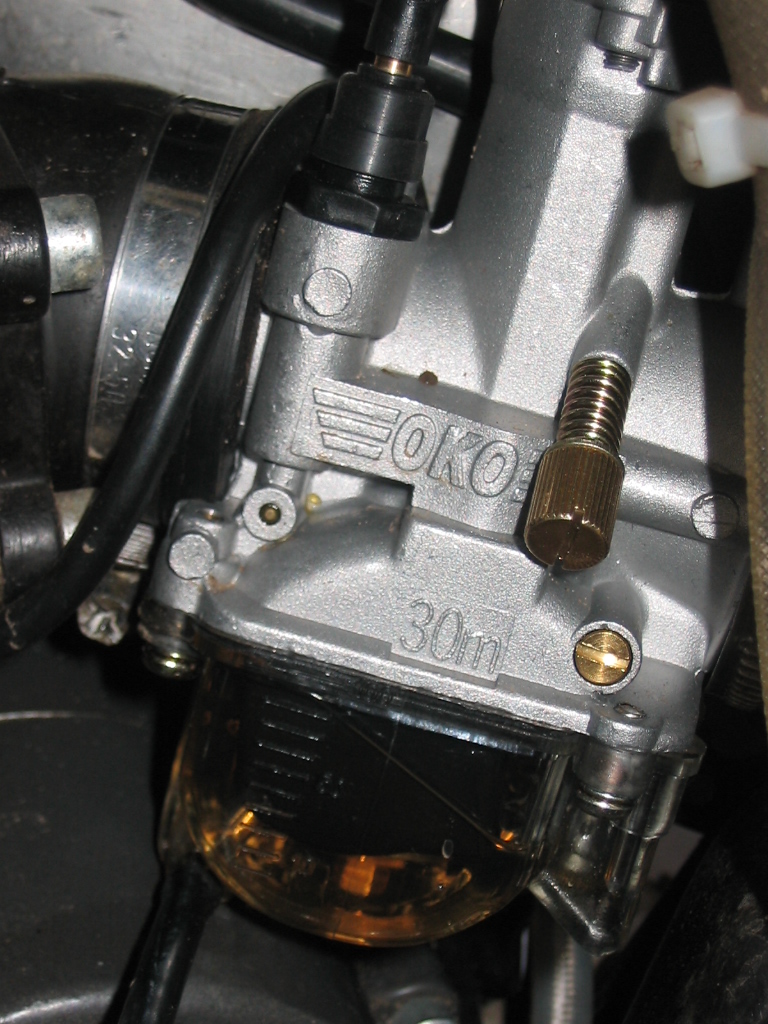

I've attached a photo of my OKO in action (note, this was taken after several rides and I had not cleaned it)
You'll note it's a 30mm!!!....with OKO there's no real difference to the 28mm (for Trials) because the venturie is elliptical, so it's an identical width to a 28mm anyway.
Another critical factor is vent tubes (if you choose to fit them). These MUST breath freely. And the top vent is located on the exhaust side on an OKO. Fit your tube inside a wire spring. That way you can bend it down (next to the exhaust box) without it creasing or melting against the box.....sorry about the fuzzy picture.
Make the one on the float blow 5cm or 6cm, straight out. And cut the ends of both tubes at an angle. To reduce the chances of blockage.
