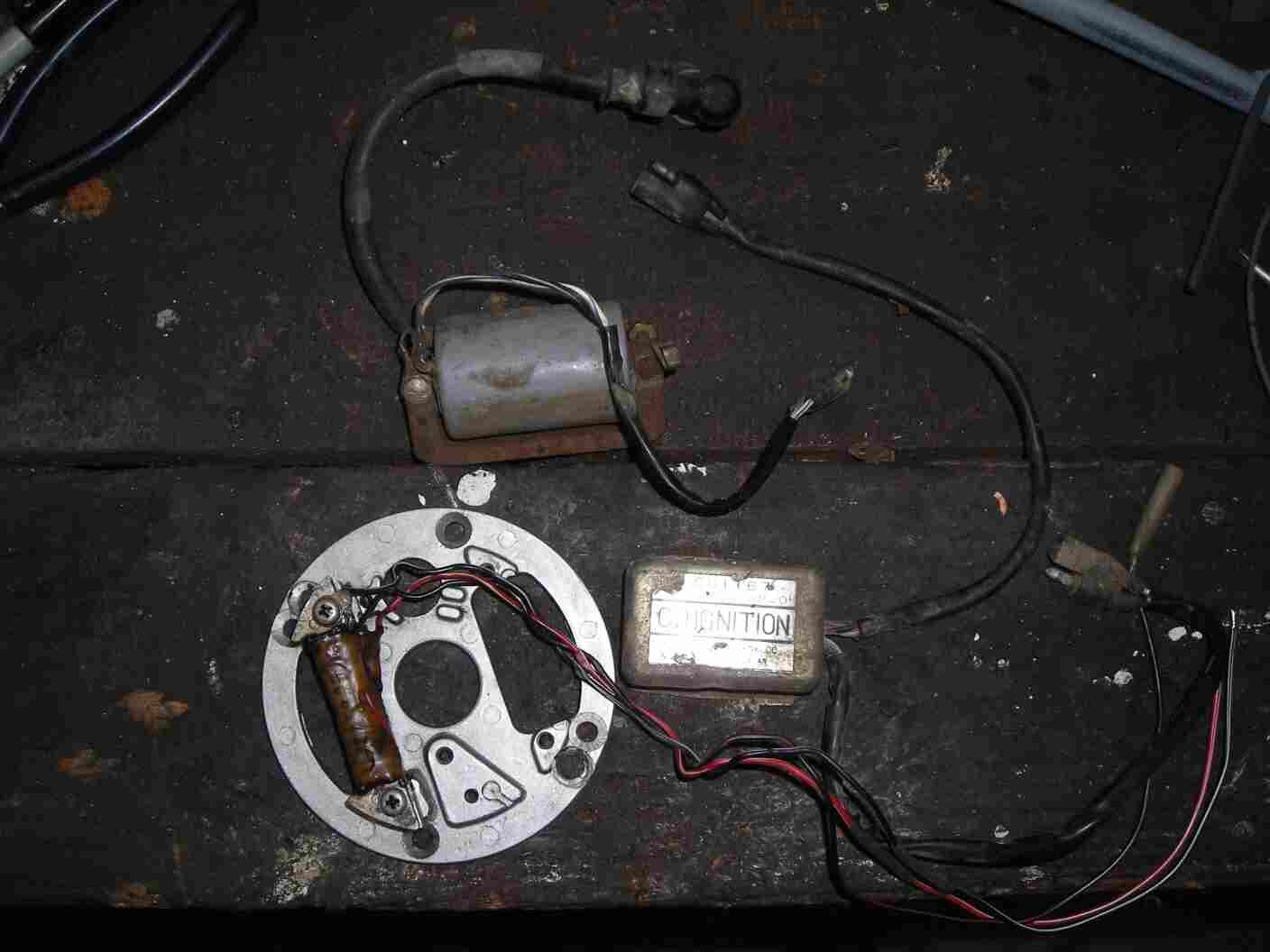

The ignition is CDI, but not one of the US or UK kits. It is a bodge-up by a previous owner - looks like CDI unit from a suzuki. The stator plate has been modified to accept the coils, and drilled with countersunk holes to mount it to the crankcase. As far as I can see this means the timing cannot be adjusted which could be a problem. It seemed to run OK when I recently bought it so hopefully the timing's right. I guess with some careful machining I could make slots to mount the stator plate and make the timing adjustable.

Here's a pic

From the photo, I cant really see what the trigger is for the CDI, (usually a separate sensor coil that set up with a timing lobe). I think its really a TCL system as in electronic points.
All I can suggest is to measure the distance the piston falls to the setting of the points timing mark, and mark this on the flywheel as a reference to a known point on the casing. Then you could power a strobe timing gun off a 12V battery and pickup on the spark lead, start the bike and see if this timing mark is close, rev it and see if it advances. Might answer a few questions for you.
Re: ty175 crank seals
Gday, that looks like the CDI from a PE Suzuki. It'll probably work OK, but as to its timing curve its anyones guess. MY PE's use those stacked coil type of arrangements. It would definately pay to check the timing with a strobe light to see where its at, before you ride to make sure you are not doing any long term damage. I reckon there is nothing wrong with points if you wanted to convert it back - really how often do you need to do anything to them when they are lubricated properly?
