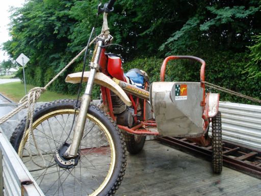

OK. Here it is as I found it. I have to thank Ron Chadwick and family for entrusting it to us. I am going to try and restore it ready for our first club day on the 1st march. #-o
Kath and I and Ron and Karen are going to share it - any other loonies want a turn? We reckon we will be lucky to negotiate the loop let alone any sections. Anyone else out there want to restore another twinshocker sidecar and tag along?

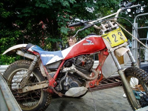

and the other side

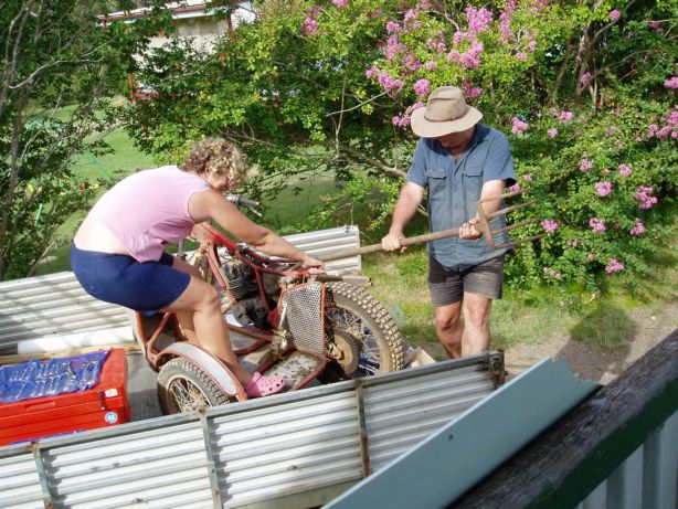

We stripped the TLR yesterday afternoon. Did some frame straightening whilst we were at it. No we were not practicing. Yes that is a garden fork. One makes do!

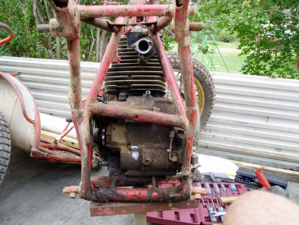

Sidecars must give their frames an absolute hiding. We found strengthening plates along the front down tuble and around the rear shock mount. There was some rewelding at joints. The swingarm has plates welded along both sides.
Surprisingly there was not any strengthening at the base of the top tube and the frame is cracked right through (aparently a common problem with TLR's). Anyone have any tricks for strengthening this area?
The pic below was taken from the back. It looks like the tube running across the frame has cracked in the middle and had a sleeve fitted over it. It has also been rewelded at both ends. I'd never noticed that this particular tube was at an angle - my first thought was the the frame was twisted!

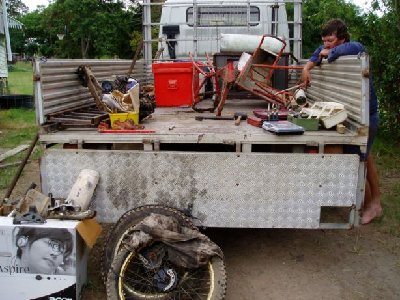

It is now officially a basket case. I must thank Terry for the tools. Couldn't have done this without them.
