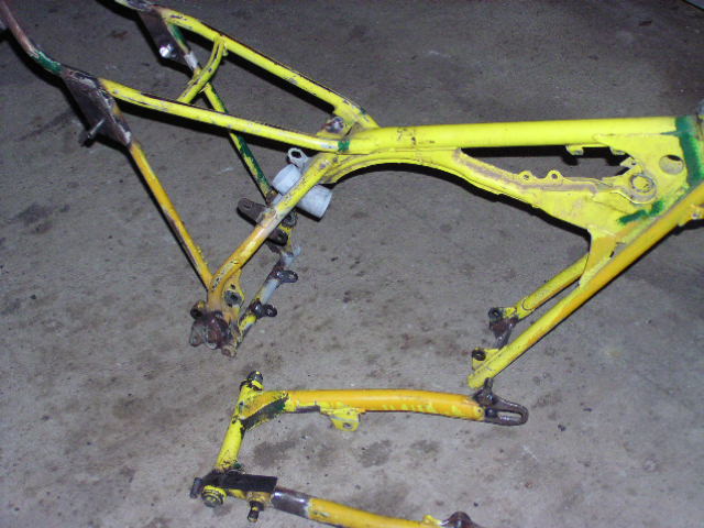

Typically, I don't have a before shot! But it was pretty bad. It had been painted with a paint brush!! It had a lovely green tank, yellow frame and an engine with a combination of the two (runs, brush marks etc). I bought it knowing I might have a few problems but was keen to ride and it was conveinient. What i didn't know was how many problems it did have under all that paint and the problems I would have sourcing a fix and parts.

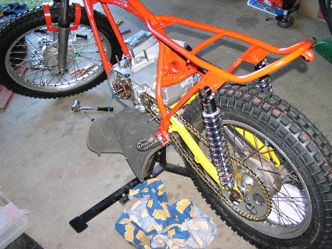

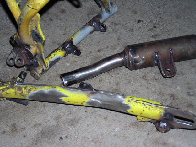

Ok, the first 2 shots are of the frame after the repairs and before powder coat and my hand made muffler. All of the mods I have carried out have been on a need to do basis ie. the pegs where worn out, bent etc. So I fixed them and moved them in the process. Keeping within the spirit of twin shock, in my opinion. Engine mounts where broken and welded on radially to the frame, so I cut them off and did it right (axially). The shock pivots where bent and at different lenghts, the snail cam pins where worn, so I fixed them all with s/steel fixings.

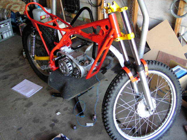

The 3rd pic is of it half done. I am sure you have all seen TY's, so I will spare you the repetition. I got all excited when it was finished and got it all dirty, so no finished pic as yet. I have a few hand made fibreglass components that may be interesting.

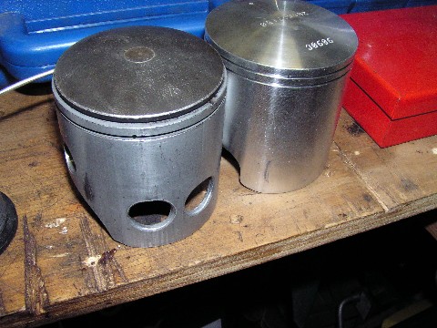

So my limit is 3 pics then. The first pic is of a wiseco RL piston and my original. With a little aid from a drill and a burr, I have 2 TY pistons. I ordered the TY piston from wiseco but returned it as it suits DT's better then TY's (more top end from bigger skirt cutaway). The RL piston was like a blank canvas...... A big thankyou to Brad from partsmonster.com.au He sourced all of my 'unavailable' parts and was happy to go along for the ride.
More frame pics and my falcon shocks :) and a gold iris chain too. I had more pics of the engine but they wouldn't fit. Maybe later.

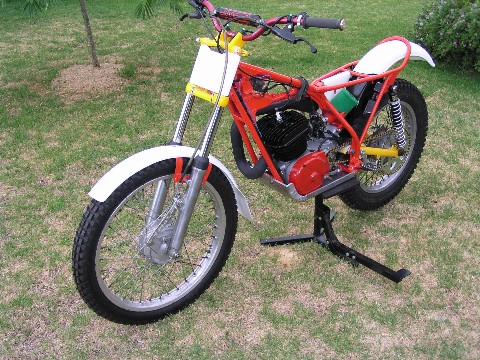

There she is, naked...... Have the pod fitted (against all advice, thats why I perservered!) and my hand made fibreglass number plate. More glass bits to come. A new dunlop on the front and IRC on the rear. Nearly ready, a little jetting to do.

It's great to hear that an RL250 piston fits the TY250. RL pistons also fit KT250s but require a spacer under the barrel for the KT motor to get the piston to the right height in the barrel. My KT has a Honda Elsinore CR250 piston in it, because for the CR piston you don't need a barrel spacer.
I think your pod filter will be fine on the TY because it is a reed valve motor so wont spit much fuel back out the inlet.
I reckon the Wiseco piston would have been fine though because the skirt length, cutaway shape and hole placement on the back of Yamaha pistons have no effect on the inlet port timing due to the reed induction.

Like to see the pics of the hand made muffler too.
