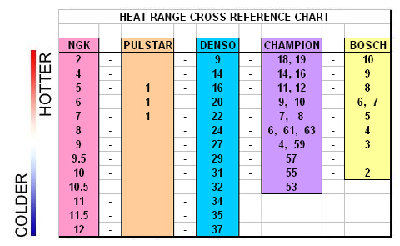

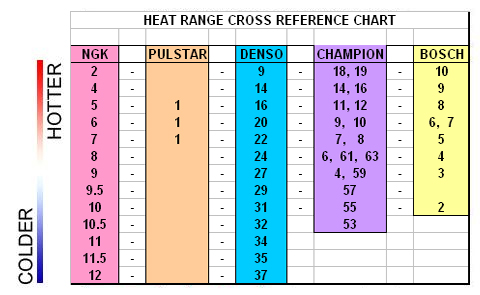

- The Hell Team
- Dealer
- Posts: 416
Re: iridium plugs
Neo
Going from a heat range 5 to a 6 is actually going to a colder plug in the NGK plugs.
Please see chart attached.
