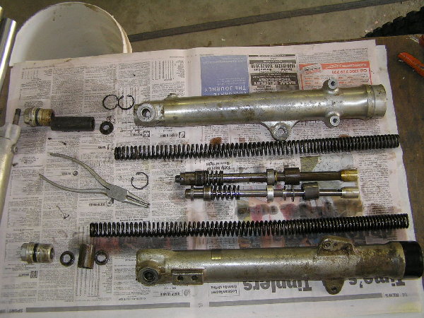

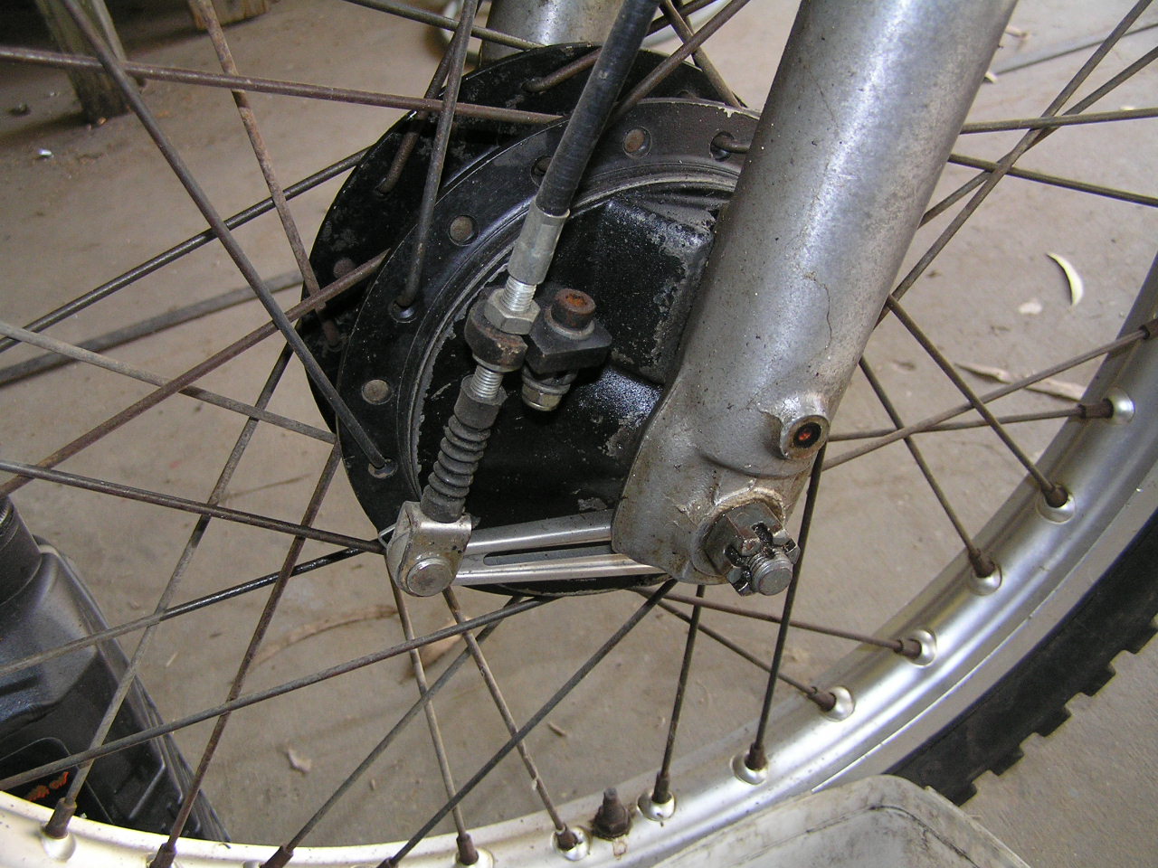

I bought a TY175 a while ago that came with a DT175 motor, odd forks and front wheel. This posting is about changing the front end back to TY175.

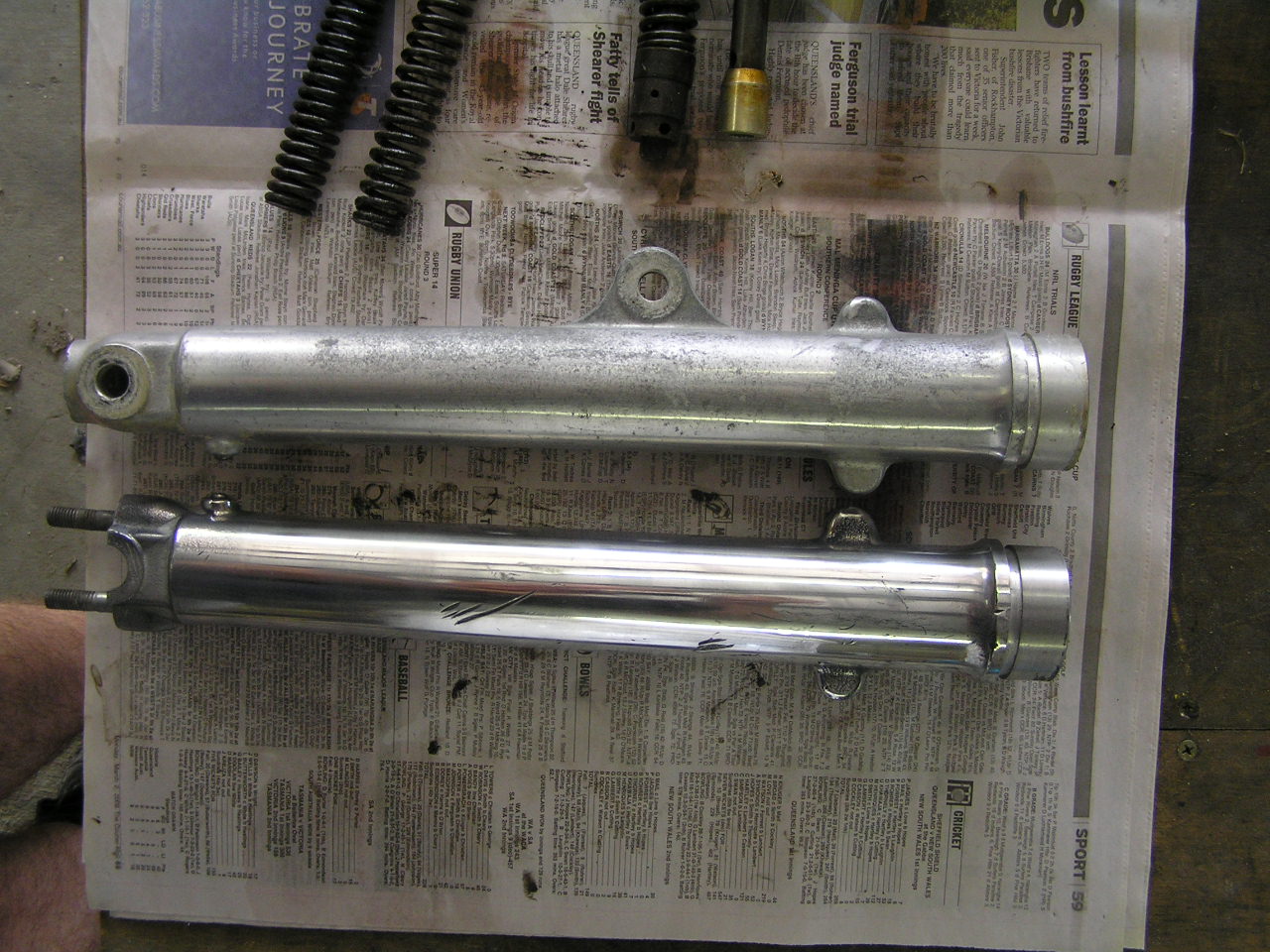

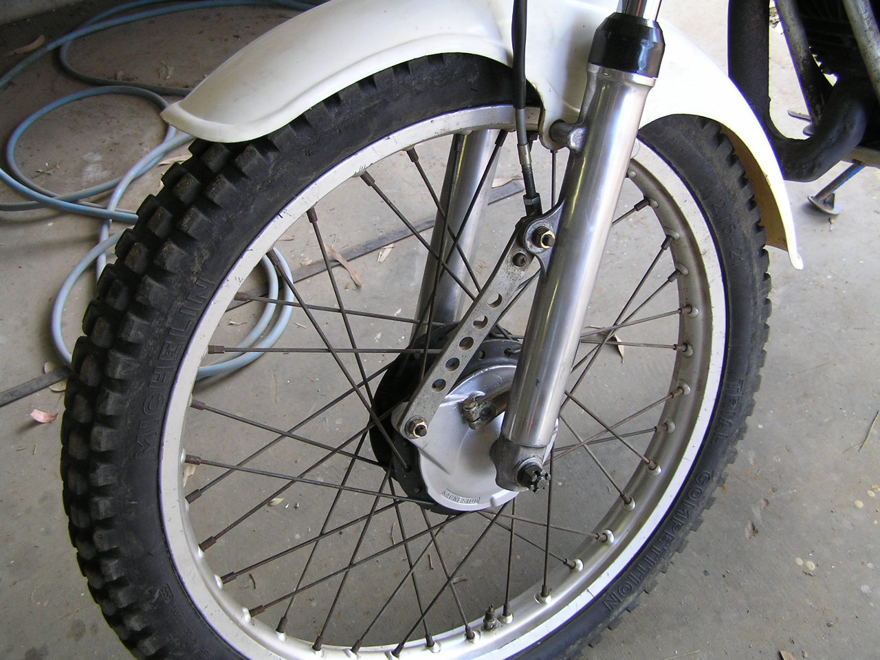

The forks had less travel than TY175 forks and the action wasn't very nice, so I rebuilt some TY175 forks and fitted them. The backing plate brake torque attachment on the odd backing plate was a slot type that fitted the odd forks, so I tidied up an old TY twinshock backing plate that miraculously fitted the odd front wheel.
I have included comparison photos of the fork internals in case anyone is interested.
TY175 with DT175? forks and odd front wheel

And here it is with the TY front end (and still the odd front wheel)

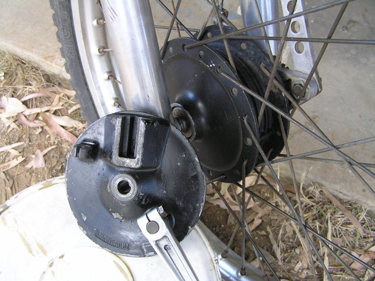

The other photo shows the odd backing plate in case anyone recognises what it is.

Is the brake plate supposed to be painted or should they be polished?
Re: TY175 with DT175? forks and odd front wheel
TY brake plates are painted (silver) to keep them looking pretty for longer than if they were bare magnesium.
The mystery brake plate in the photo is also magnesium. Does anyone know what Yamaha it is from? The wheel rim has a manufacturer's date of July 1982 if that is any use.

unlike the rear hub, the front hub on ty,s are commen to quite a few yamaha models including a few road models with tin rims [19,s i think].mainly used in the early 70,s .it also stayed with a few of the cheaper models in later years.that 82 rim in your pic david could be a dt as you say or even a ag model. few years back i came across a few brand new road wheels with these hubs.all in all its good for us blokes cause front hubs are easy to come by! if you look inside it will have the code 248 which is the code for an AT1. the first model to use this hub. backing plates however were differant. hope this helps.

Thanks Adam I didn't realise that hub was so commonly used.
The backing plate still has me stumped because there is nothing to drive a speedo from on the hub or the backing plate. Maybe it's a backing plate off a kids bike like an RT100 or TTR90 that doesn't have a speedo - but why would they use magnesium on a bike like that?

Mystery Solved - I was talking to the "Known Bike Fiddler" this morning who said the bikes originally came from Chris Noon in Townsville. KBF's fading memory says the forks and backing plate are AT1 or CT1 (pre DT) and the rim is early YZ. The extended cable retainer was made up to accept the longer lever which came from his secret supply of Yamaha "Bucket Road Racer" stock.
