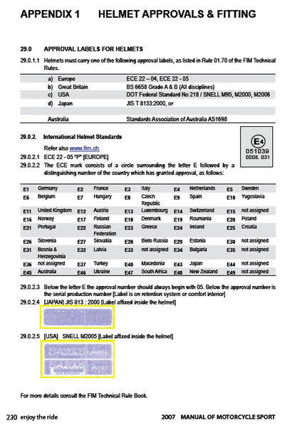

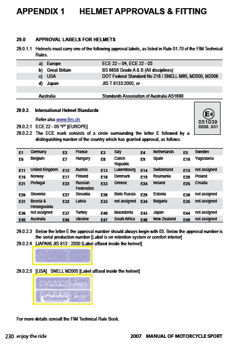

If you check the MOMS you will find helmets for competition use (all disciplines) do not have to have an AS compliance if they have one of the other accepted International standards. Most trials helmets sold in Australia have Euro compliance. These standards are actually more stringent than comparable Australian standards. (the crash tests are done at a higher speed, and with a heavier projectile).
I have attached the relevant page from the MOMS below.
