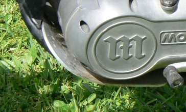

While I've got you here - when I bought the bike it had an aluminium bash plate (see below) - which Greg Harding noted was set between the engine and the frame thinking this was incorrect. With the engine out I removed the plate and I am not sure it will fit below frame and if it does with the required spacers it could reduce clearance by a centimetre - does anyone have experience with this kind of bash plate.
Re: Cota 247 no spark
Yes it is meant to be between the motor and the frame. Unusual and provides no protection for the frame tubes but that is where it was made to go. I've seen similar bashplates made for fitting between motor and frame tubes on Cota 348s too.
