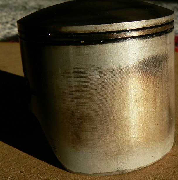

I finally got the piston out - that gudgeon pin was sooo tight. Here is an image below of the exhaust side of the piston. The camera shows up the marks more obviously than the naked eye - the other side is smoother although see close up in next post. I also note that this piston feels much tighter in the bore - it sticky at several points.

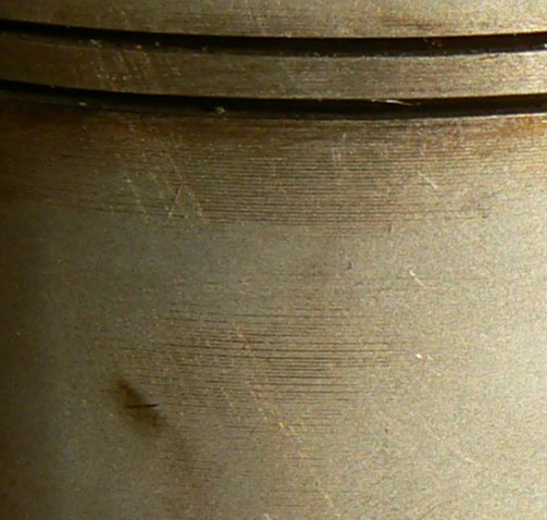

the inlet side of the piston - close up machine marks disappear towards the top - is that normal?

Re: Cota 247 Running Lean and Overheating
The wear pattern on the piston look normal to me
The other things I see in your photos are:
The air filter has been well maintained
There are no signs of seizing
Photos of the carbon deposit patterns in the bore might provide useful information about how well the rings were sealing
Photos of the piston crown, spark plug tip and interior of the head might provide useful info about possible overheating episodes

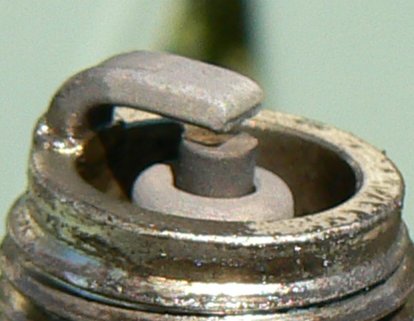

Put everything back together and again cleaned all jets and set needle at highest position. Adjusted idle and mixture to get a reasonable idle- I then ran the bike at trials pace over logs etc for 15 minutes well and truly warm - engine was idling probably 300 rpm higher than to begin with. The picture below shows the plug which was brand new B7HS
So I went back through the old carbie parts the old main jet is marked 150 but on closer inspection it is significantly bigger and would appear to have been drilled (which was going to be my next move) so I installed the old one and now having trouble starting as the plugs appear to be loading up (good sign) and I am all out of new plugs . I'll let it rest for an hour and see how I go,
