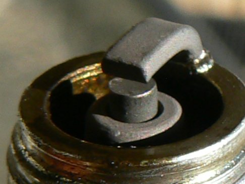

Eventually got it going with the 15 minute old B7HS and it felt really good - lot's of low down response with no lag so i gave it another 15 minutes up and down our steep hill climb and it ran well and idled well - here is the same plug after this run - it still looks a bit lean to me . I will take it for a fair dinkum ride tomorrow and see how it goes.

Neither plug photo shows any indication of the motor running lean.
In both photos the gap looks too wide. Looks like 1.0mm, should be 0.5mm. Having too big a gap has no effect on motor heat output, but it might run better with the right gap.

I don't like to disagree with you but the first one looks lean to me . The earth electrode change of colour is the part that looks lean to me. It's been getting to hot. Although a photo is never as good as looking at the real thing. I agree with the plug gap being to wide though. Better get back to packing planes for tommorrow.

Must be camera distortion the plug gap was 0.55 so not that far out.
