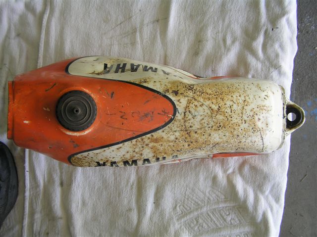

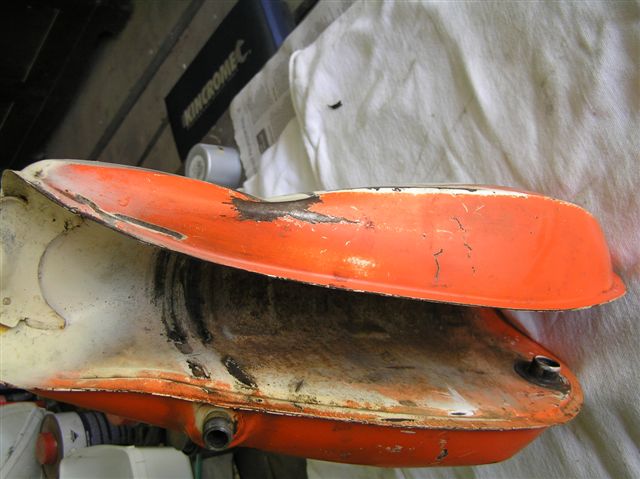

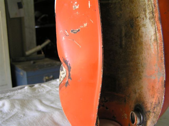

I've got a couple of steel twinshock fuel tanks that have suffered serious denting and am going to have a go at straightening them out so they can be used. The idea is to use low pressure compressed air and a special jig to hold the tank in shape while I use localised heating to soften the steel, letting the air pressure push the dents out. I have borrowed a TY175 tank-holding jig from a friend and seen the results he has achieved on other TY175 tanks using this technique, so it should work OK.
Special safety note here to point out that the tank in the photo has already been meticulously cleaned out to remove every trace of fuel residue before I start heating it. To clean it out, I used clean petrol, then turps, then water, then dishwashing liquid mixed with water, then water again. This tank has no internal rust, but if it had been rusty inside, I would have removed the rust too, probably with molasses.
Here are some "before" photos of the ex-Hagsta TY175 tank. Note the gearshift pattern guide written on the top surface - cool hey?

Those tanks look like perfect candidates for an open up, panelbeat and weld back together. That's the way I did a repair job on our TL125 tank. Just grind the seem all the way around and the tank comes apart. Then belt out the dents and just weld it back together with a small OXY flame . Bit of bog and paint and Bob's your uncle.
