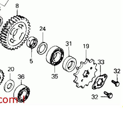

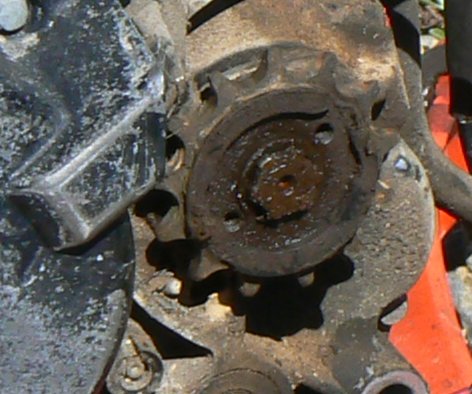

I have removed the front sprocket which is very lose - not on the drive direction but left to right across the engine. I have what I thought was a details owners manual but I can't find a diagram of the drive sprocket so resort to CMS.nl exloded view of Reflex 200 86 model (see below) and its completely different to what is currently on my bike - refer pictures below - my sprocket has no fixing plate and no oil seal on the drive side - in fact the sprocket is held on with a rather flimsy circlip - surely that's not right. I can see the holes for the fixing plate but I can't figure what the plate does what is it fixing to - how does it hold the sprocket onto the spline?
- drivesprocket.JPG (30.39 KiB) Viewed 6360 times
- counterspr.jpg (45.7 KiB) Viewed 6360 times

The bracket is fixed with two 6mm bolts with blind heads. either drill a small hole and use a screw extractor or just create a slot in the head of the bolt and screw it out with a flat blade.

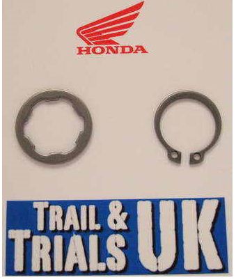

I found this at http://www.tytrials.co.uk/trailandtrial ... TL125.html - so it appears to be correct but mine doesn't have the washer thus the excess movement
For fitting Talon front sprocket which has a shoulder so cannot accept the bolt on tab.
Washer goes behind the sprocket with the circlip at the front.
For all years & models of Honda TLR200 including Reflex
- circlip.JPG (28.48 KiB) Viewed 6309 times
