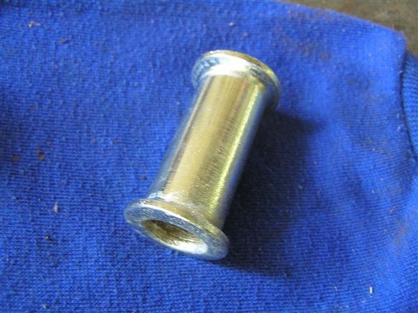

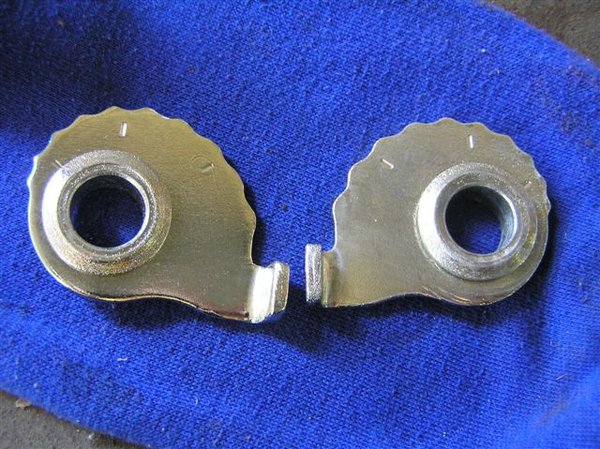

I've finally had a go at doing some replating for a project bike and the first batch came out so well I couldn't resist posting some photos
Its good fun too
TY250 twinshock rear axle parts, zinc plated
Replating old bike parts at home

Hi David, nice work on the zinc plating. The results are very satisfying, re-zincing everything brings a resto to another level.
Looking at the snail cams it is hard to tell if spotting near the centre is pitting in the steel or specks of zinc build-up. If it is Zinc, lowering the amps a little will stop this.
It is necessary to adjust the amps according the the surface area of each job though. A very light fizz on the copper wire the job is hanging on is the easy way of judging this. There are a few surface area calculators on the net if you want to be more accurate about adjusting the amps.
Steve

sharvie wrote:Hi David, nice work on the zinc plating. The results are very satisfying, re-zincing everything brings a resto to another level.
Steve
Thanks Steve. The spacers in the centre of the snail cams do look a bit funny, but in this case it is just because the steel was pitted and I didn't bother skimming the surface to get rid of the pits. I have had that issue with specs of zinc sitting on the surface with some of the other parts. It's fun learning as you go with it. Another mistake I made on some other parts was to have the piece being coated too close to the surface (air interface) of the electrolyte. Another was to have the end of a long bolt too close to the wall of the plating container. I'm loving this. Can you tell?
