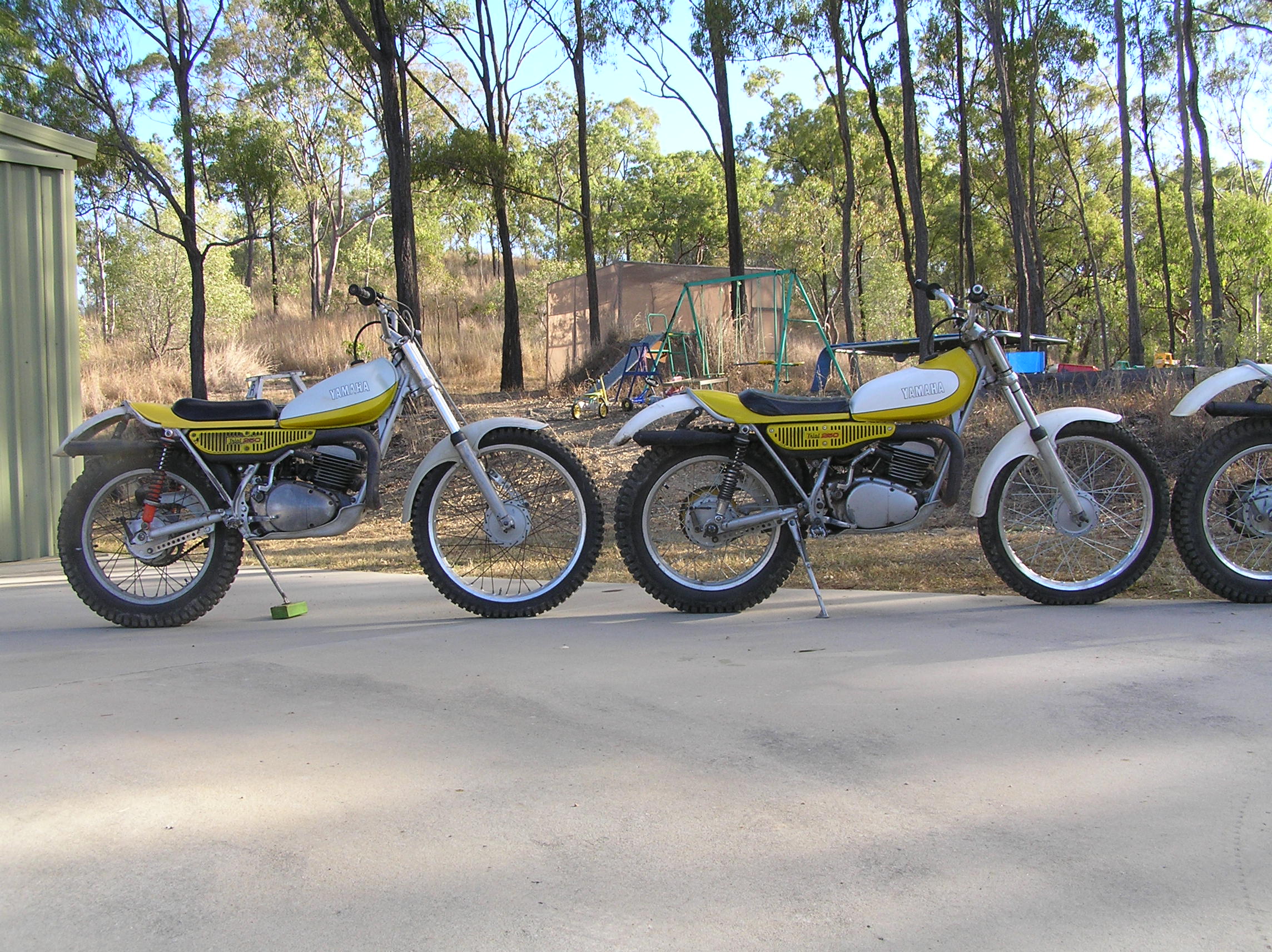

For the yellow on TY250A and TY250B I use Power Plus rattle can "Absinth Yellow". It is the closest I have found to the original Yamaha "Competition" yellow available off-the-shelf. You may get a closer match by getting a spraypainter to match some paint by eye from an original sample. As far as I know that yellow it is not available as a coded automotive paint colour.
I'll see if I can find a side-by-side photo showing both original Yamaha yellow and Absinth yellow
The light silver colour on the TY250A fuel tank, headlight and mudguards is called "Tober Pearl" by Yamaha and is also not available as a coded colour.
Re: TY 250 A/B colour codes
The A model fuel tank and exhaust shield are the original Yamaha paint. The A model seat surround is some other yellow and I can't remember the name of it but it is not as close to original as the Absinth yellow.
The B model yellow parts are all Absinth yellow
Click on photo for full resolution photo
