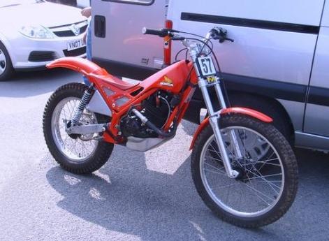

Anyone know if this bike is a mono converted to twinshock, or was it built like this?

I've seen similar or maybe the same bike in a photo posted on Trials Central a while ago and that one was an RTL converted to twinshock rear end. It sort of falls into the same category as Yamaha monos converted to twinshock rear end.

Its a converted mono............which I think was done by a guy here in the UK who prepares speedway motors. RTL's dont handle that well though, and other than the exhaust, air box, and CDI unit, the motors are pretty much exactly the same as the TLR250, which would probably be just as good as the converted mono, with the above changes carried out.

Thanks for your reply David and FM350, thought it was a converted mono. Looks like there would be some difficulties with the exhaust once two shocks are fitted.
Wonder what was done to mount the shocks at the top, as this section of frame is removable.

I've seen that bike around somewhere,cant remember if it was at a trial or at a show,cant see the point personally.Left as a mono it could be ridden in the over 50 mono class,wheras as a converted bike it only annoys riders on "proper" twinshock bikes.Plus what is its value ? As an RTL there is a good market price,as there is for a TLR250. As a conversion I think it would have dropped in value.
They look and sound lovely,but thats about it - there are much better bikes around.Maybe I'll now get around to finishing my XT225 engined Ty175 as my idea of what would have been if Yamaha had gone 4 stroke.
