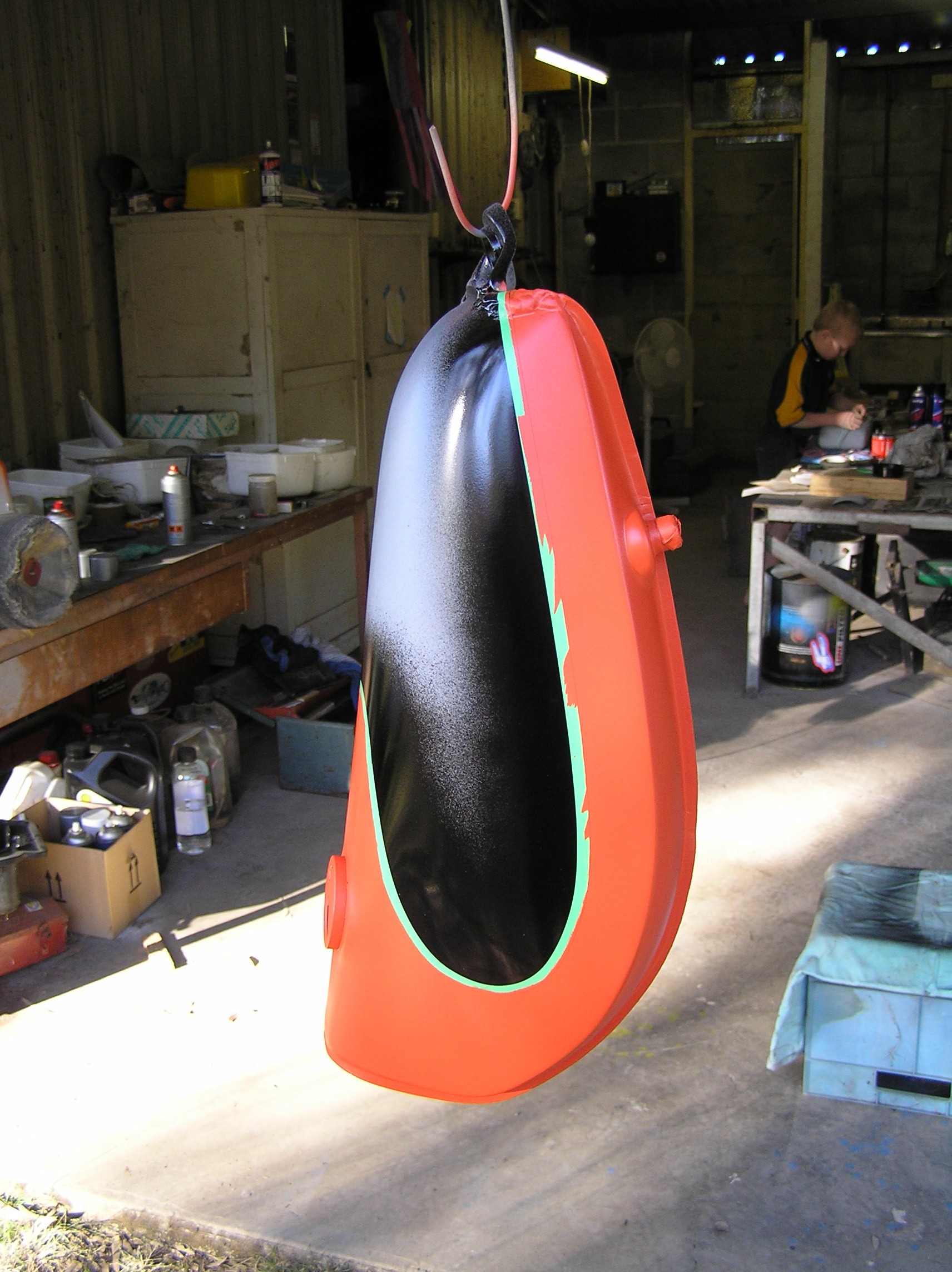

Yes Stu you have got it, but the standard RL scheme was orange where my colour scheme has yellow. I wanted to do orange but couldn't get an orange rear Ty175 guard so I made it to look like Mark Reed's RL250 which had yellow where the orange should go.
Yes BOGWHEEL that TT500 does look very similar in the colours. I hadn't thought of that.
Stu are you sure I didn't spill the beans with you at the Denman 2 day last weekend about that colour scheme?

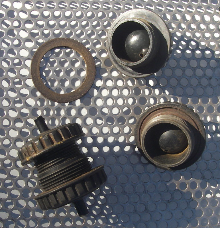

Below is a photo of some TY fuelcaps, cap which fits inside is the same as the top one with the separate seal. The bigger one is the same as bottom right. Does anyone know why or what causes this?
I'm not sure Greg but the one that shrunk on me was one that was in a tank that had no fuel for a few years. I haven't had one shrink while there was petrol in close proximity. I tried soaking the shrunken one for ages in a bottle in petrol but it never grew back to full size!
One basket case TY250B I bought many years ago had a hand-made replica of the original cap made from solid black plastic even with the serrations hand cut. It is quite a work of art. There were lots of hand-made parts on that bike - very inventive. Another interesting variation was that the swingarm pivoted on a steel inner tube that was held in place with a 1/2" whitworth bolt at each end instead of the usual through-bolt. Another was the rebushed rear brake backing plate that was a bit tight on the axle so that it was quite an ordeal each time I had to take the axle out.
Another thing while we are on trivia about TY fuelcaps is that the TY250A cap is different to all the others. The later ones have a recessed sealing washer. I only know about this because the bloke at my local Yamaha shop gave me an ear bashing after they bought me in a cap for my TY175B. When I was asking them to order me one in, I said - "don't worry Cyril, you can use the TY250A parts fische, those TY fuel caps are all the same" Didin't he give me a hard time about that one - turns out he is quite pedantic about those sort of things.

Last christmas I was flushing out a TY250A tank which had been sitting for 6 months full of mollassis to cure any rust.
I had the tank upside down draining for a few weeks, then was faced with the task of flushing out remaining residue.
SO .......... a pair of heavy leather gloves and an unending supply of boiling water.
I put a defunct tap on the bottom, threw boiling water in and the fuel cap on then shook like buggery for a few minutes.
Throw the solution out, attend to the beer on the fence post and then repeat the procedure.
You get the picture.
Took perhaps 20 - 25 cycles and all was clean.
So all was good. I installed a good tap and threw the tank on the bike and pottered around on it for the few minutes that the beers part of the whole operation would permit.
The next morning however, the fuel cap had shrunk in exactly the same manner as your photograph depicts. The thread would not bind at all.
So your guess is mine, but that cap never recovered.

The smaller ones are made to accept a helicoil

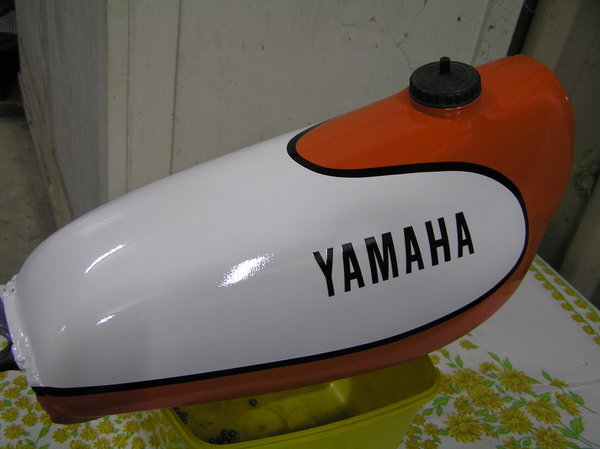

I'm so proud of how well this latest TY175 tank paint job turned out I just had to show it off. Scorps told me how to do the pin stripe using paint instead of a stick-on stripe and this is the third TY175 tank I've done using that technique and is the one I am most happy with.
For any professional spraypainters looking at this, don't worry, I know it is far from perfect. I'm just happy that it looks a lot better than the ones I have done before.
