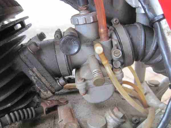

Im getting my head around the mods that have been done to my newly acquired TY-175
The autolube pump has been disconnected, and from my reading, I gather the unused oil-line on the carb must be blocked off, or it will suck air, and run lean.
I should point out - the bike starts first kick, and runs quite well (a tad smoky, perhaps)
The previous owner insists the premix ratio MUST be 30:1 which sounds a bit rich; I was thinking it should be more like 50:1 (comments, anyone?)
The 30:1 requirement is what prompted me to confirm that the oil-line was correctly blocked. When I took the oil-pump cover off, two cupfuls of rusty brown water poured out! Eeek! The cable hole had been blocked with a bolt, so I assume water was getting in at the top of the cover, but being held from escaping.. The pump was in place, but wrapped in 5mm of brown sludge. Fixed now.

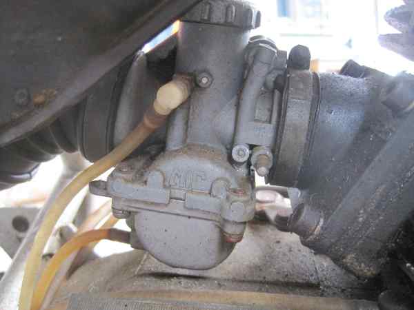

[Q] Ive attached some photos - Can someone point out where the oil-line used to go on on the carb? (A bit of a naive question, I know)
[Q] You will see I have 3 breather/drain lines - is this normal?

In the left side photo the oil port is the one closest to the cylinder. Hole points horizontal right. Can't tell what yours is plugged with from that photo but whatever it is it appears to be sticking out 10-12mm from the carby body
The vent and overflow hoses are all correctly fitted. The one that comes out the bottom is the float bowl overflow line. It is a standpipe. Other hoses are float bowl breathers
