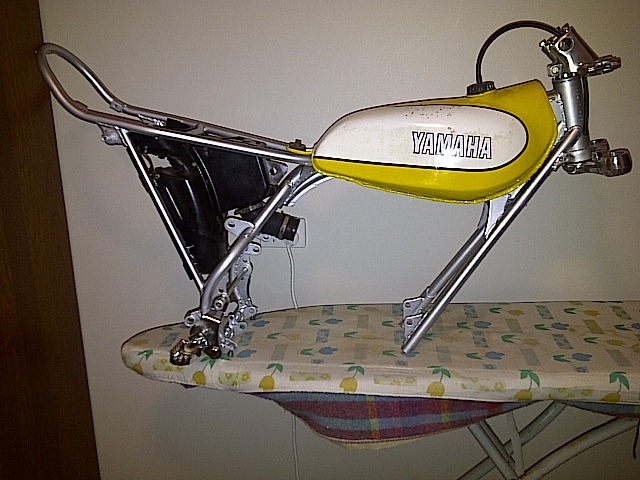

Quick update on the "B" -progress is a lot slower than I thought!
-I re-cut all the threads on the frame on the easter weekend
-colour sanded the original tank and shot a coat of clear over it (looks a little dodgy, but looks a lot better than an untouched 40 year old tank)
-Cleaned up the air box and found some new bolts for it.
-polished the triple clamps up on the buffing wheel and replaced two threads on the clamp holder with "timeserts" as two bolts broke
-new steering bearings fitted with new bearing covers and top adjuster nut
-fitted the new Sammy Miller footpegs and mounts (had to machine up 2 stainless spacers as they would not bolt up "true" to the frame)
-I dropped the wheel hubs and magnesium backing plates to Greg who runs "Hydroblast" in Moorabbin, they should be ready for collection early next week
Swingarms currently on the workbench - machining up parts to make the chain guide "as new" (chain guide mount was out of round)
Bought all new swingarm bushes / shims / end caps, so hopefully will have a restored swingarm back on the frame by end of weekend
QUESTION for the day: anyone know of any web based stores that sell Falcon shocks apart from Falcon themselves? Anyone had any luck with Rockshocks rear shocks ? I need to order shocks soon, and have decided one of these two brands seem the better picks, Rockshocks seem easy enough to get, cant seem to find anyone who sells Falcons, and the local distributor appears to be selling them for double the recommended list price...

- ty250 build up.JPG (229.09 KiB) Viewed 6232 times
