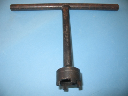

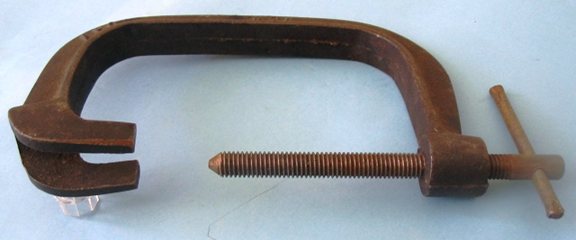

While we have topic on Tl125 - I thought I would alert you an opportunity to acquire two tools that may come in useful - have had them since '76 - the OHC valve compression tool and by memory the four pronged tool to remove the oil pump. Usual story - only ever used a couple of times, only ever on weekends or late evenings and saved hassles of trying to find an equivalent in the back shed. Let me know if you are interested and we can sort something out. Pick up in WA or cost of postage over east/overseas. These are genuine classic - worthy of restoration to prestine condition. :D :WA:
ohc valve compress.jpg (78.48 KiB) Viewed 5357 times
oil pump tool.jpg (54.92 KiB) Viewed 5357 times
