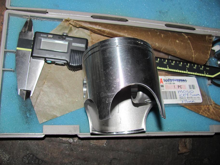

Wiseco MX piston with large crescent cut-out to be assessed!!

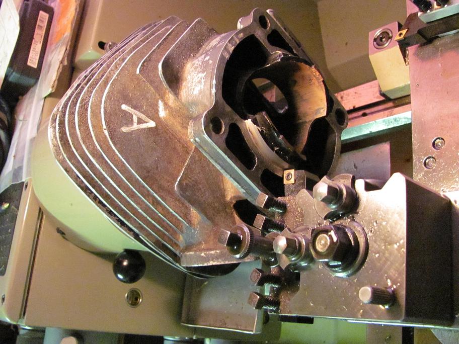

Barrel height about to be reduced by 2mm to accept short stroke crank

Remember the point about pistons particularly 70mm types, well here is the Wiseco ex-MX variety that most Hamilton Yams are fitted with, note massive crescent cut out at back as opposed to the tiny windows in the skirt of standard. Birketts and Thorpe recommend these so good enough for me, its just that in say a Fantic, the lack of skirt soon causes wear due to the piston thrust and the dreaded rattle/slap soon onset! Anyway, if its OK by Thorpe & Co, then its OK by me. They do recommend that the bore is honed so piston "just" fits, any bigger and it will slap. So my piston is 70.50 and cold the skirt measure 70.39 so thats what I instructed machine shop to do!
Secondly, as its now a short-stroke, I have to loose 2 mm of barrel height because my crank stroke is now 66 and not 68 standard, so have just set up barrel in lathe to remove 2 mm off base. Third job for later is to set ignition timing so pick up coil is at around 5 oclock position rather than TDC but more of that later.

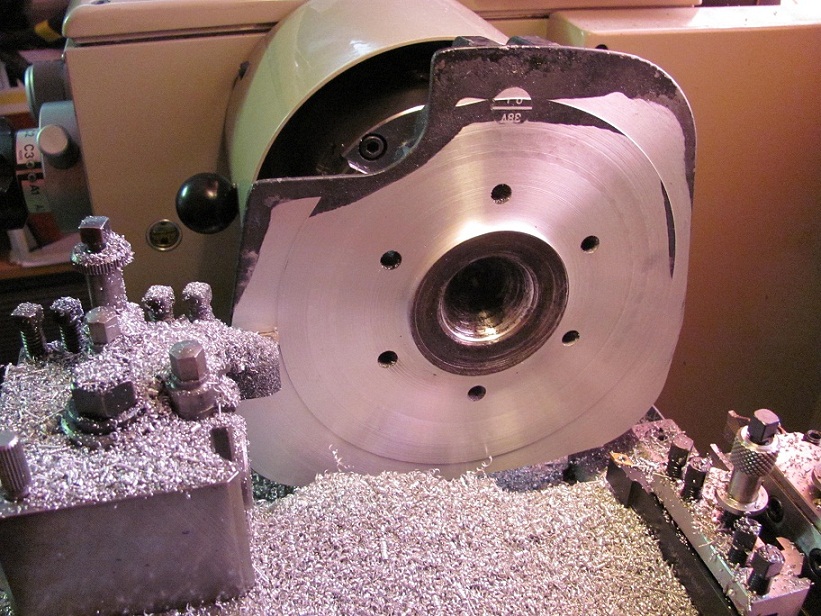

Hi reader, to continue ... head needed machining to increase compression ratio, basically had to turn down the head to produce a raised combustion chamber to fit some 5 mm down inside the bore. Birkets piston must have been a twin-shock variety with a lower crown height but anyway got round it without too much grief to give me a squish of 1.1mm without the copper head gasket. However I can run with just a thin seal of mastic to the head joint as I have tried this previously without any probs.
Total reduction needed was some 9.6 mm of which 0.6 was for base gasket, some 5 mm off the head and some 3.0 mm off the barrel base.
Anyway much more than I expected but there is plenty of spare to go at and I have arrived back with good compression, scavenge and just about 1mm squish.

Skimming some excess metal off head to move combustion chamber back down cylinder.
