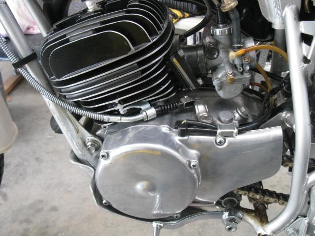

12 see any thing odd let me know
12 motor LHS (Small).JPG (61.26 KiB) Viewed 5213 times

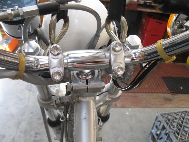

14 are the old yellowed cable straps the right ones
14 cable clamps (Small).JPG (55.44 KiB) Viewed 5213 times

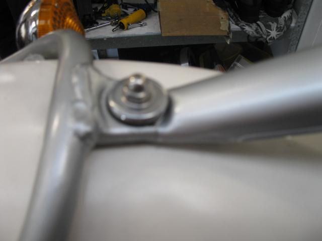

17 is this the right washer bolt and tail light combo
17 nut and washer (Small).JPG (25.54 KiB) Viewed 5213 times

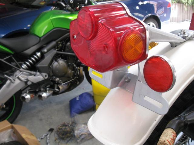

18 this is a reproduction of the right tail light except for the real one has a red side reflector. Yellow is a US thing it thinks.
18 tail light lens (Small).JPG (51.21 KiB) Viewed 5213 times
18.1 I have a original lens but it doesn’t quite fit the reproduction base plate. Any one with a original base plate I would be interested. Plus are these round reflectors on each side for our bike
18.1 lens base (Small).JPG (39.29 KiB) Viewed 5213 times

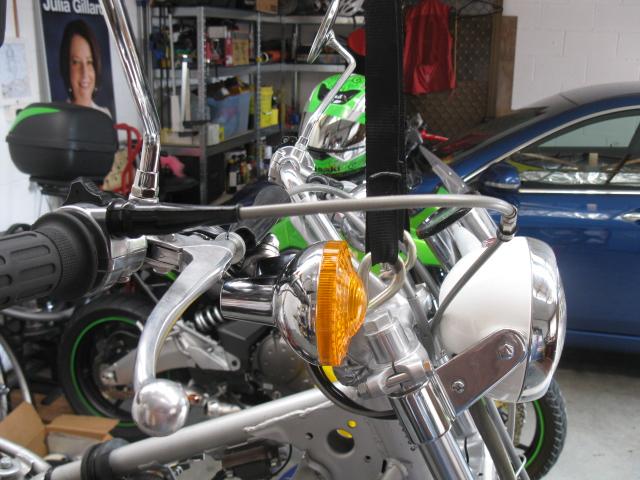

19 is that how the throttle cable runs
19 throttle route (Small).JPG (63.66 KiB) Viewed 5213 times
20 is that wire loop for the brake cable or the throttle cable on the other side
20 brake or throttle (Small).JPG (48.05 KiB) Viewed 5213 times

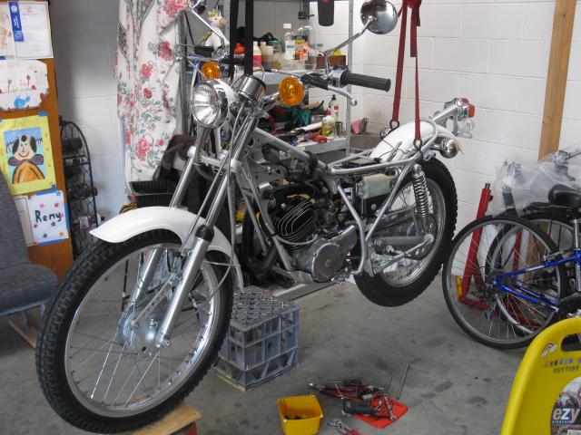

21 see any thing odd let me know
21 lhs (Small).JPG (68.91 KiB) Viewed 5213 times

13 wrong plug cap
14 don't the handlebar electric cables run through the middle of the bars?

13 Wow I hunted up and down the wreckers some years ago and decided they looked right. Now I have no idea what one should look like. I will have to see if you can get them new but original.
14 no way are the left ones fitting inside the handle bars. I will check out the right side thanks

I'm only going by memory for the plug cap and memory is saying that there is no screw clamp on the original cap. Memory is also saying that the JC cap is big, black and bulbous. Another thing to check out on my sister's bike
