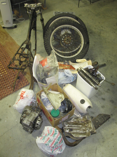

I just bought this for $400 should I be pleased?
It comes with lots of new in the box unopened parts like piston kits, air filters, gaskets, The motor seems ok and it has a good low mileage piston in it.
From what I’m told I’m now the 3rd owner as it the original owner used to live in Toowooba used it in comps moved to TAS had some accident and smashed his knee then striped it to rebuild with his son who lost interest. The second owner bought it with a ty175 1978 in really good condition but didn’t do any thing with it either.
I don’t know any thing about Trials competitions but it comes with a range of front sprockets starting at 12T, 9 sparkplugs new and old, 2 carbs, handle bars, leavers, throttles, 2 bash plates one fibreglass, lights and switches removed and in a separate bag in good nic .The tank and covers are painted in this thick white or now mat cream paint?
1st question. What confuses me is the frame is black and there is no sign that it ever used to be silver. The swing arm is silver, the motor is silver with black cases both sides. The motor and frame have matching numbers?
2nd question. I have a mint TY175JC that I’m to worried about to ride. I can give this one a degrease, scrub and major service. But do I spray it with silicon to protect it, clear or repaint and have another molested bike I cant ride?

Ride It ! =D>
Ross, the TL is looking good! Your lightweight seat is consistent with the lightweight tank Honda fitted. Often wondered if it was a too little too late effort to keep the bike under 100kg?
Eric, definitely should be happy with your investment, $400.00 does not buy much anymore! Because you have such a nice TY175JC, I can understand why you are hessitant to ride it. The fibreglass bashplate might be off a TY250A? With the frame being black, check the frame number, should be 525 or 1N4?
Why don't you get the Basket Case going and have a go at riding trials? If you leave all the roadgear off and focus on function and not appearance, you may find it liberating. Lowering the care factor and not worrying about damage can make it more enjoyable.

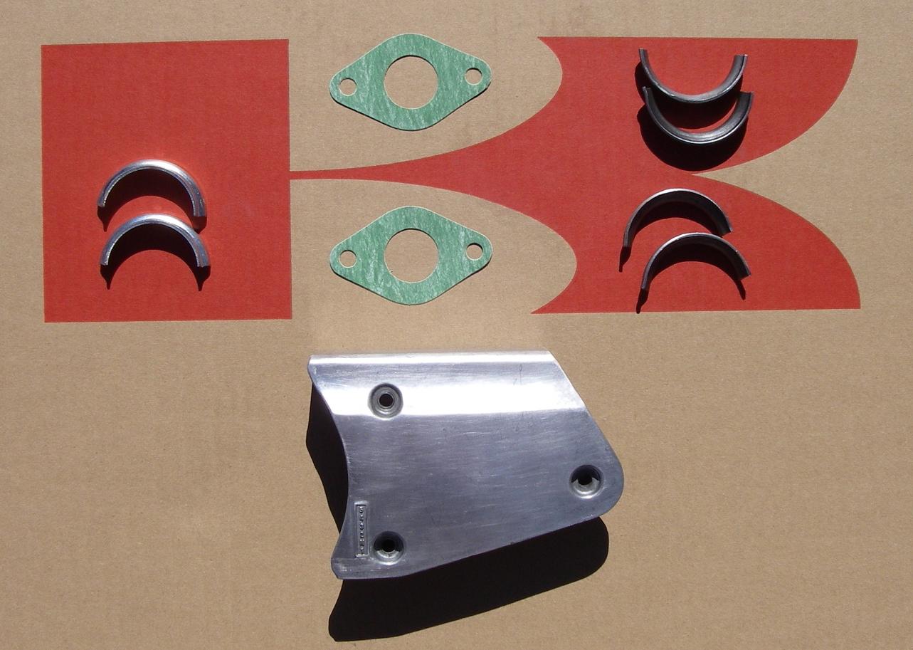

Chippy, Fred has sent over some more KT parts, we now have exhaust collets and inlet manifold gaskets. Even a sprocket cover, who said they were hard to get? All you need to do is ask the right person the right question at the right time, simple!
chippy
Posts: 143
Location: Brisbane Australia
Post by chippy »
Greg,
Thats great that you got a front sprocket cover. Yes they are very hard to get. Thats also good that you got us some exhaust collets and the gasket for the inlet manifold. I have a inlet manifold rubber on order from Mikuni Australia in Townsville, so all I need now is the heat shield piece now that protects the inlet manifold rubber and I can fire it up.
