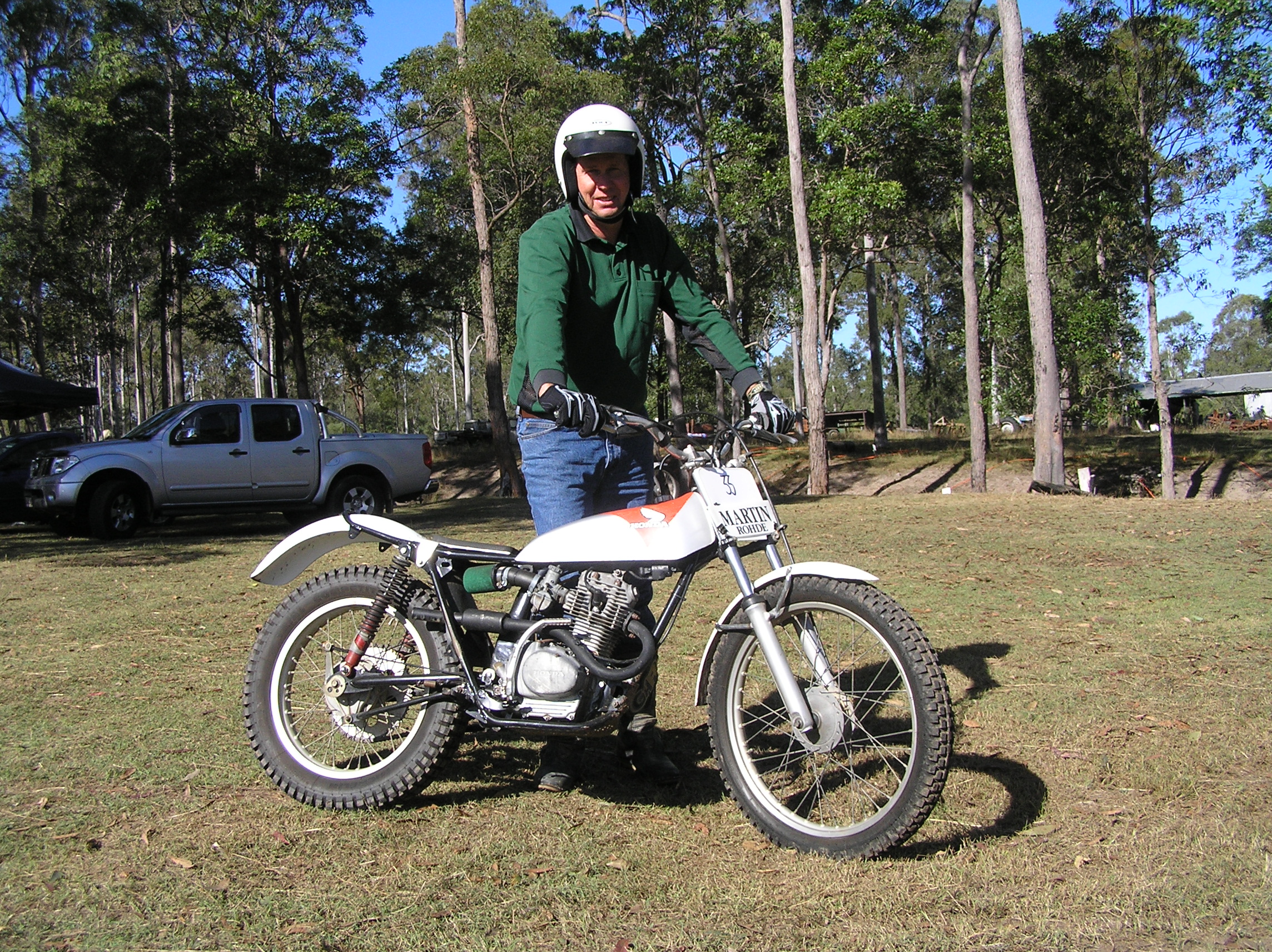

Here is an economical muffler idea used by a friend. It sounds nice too. It is a muffler from a Briggs and Stratton 4 stroke lawnmower motor Not sure but the air filter looks like a Unifilter pod filter
Hi & thanks for the replies bedouin & David I have gone with a unifilter as in the pic David and as for the muffler I am only missing the spark arrestor so I might chase up a bike exhaust place to bend up a small pipe & attach something from another bike. cheers thanks again for the info it helps heaps. Wil
