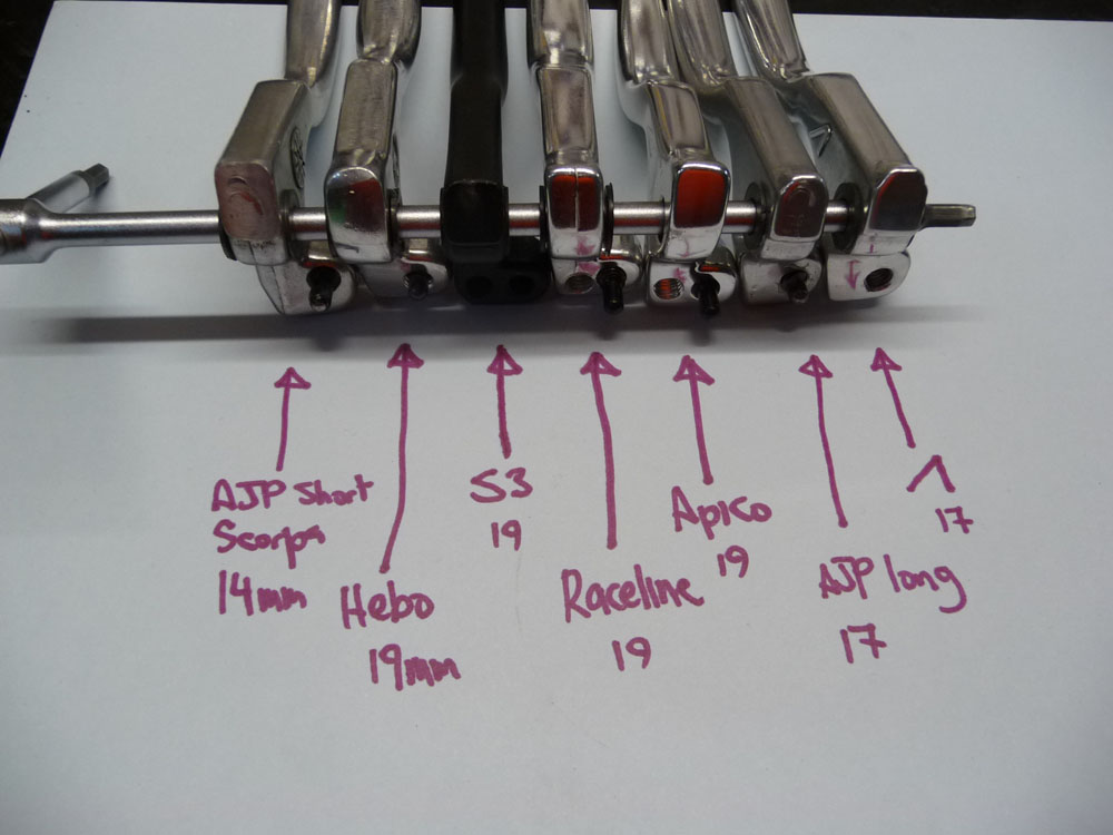

Howdy all,
Here's a question that I'm hoping someone can answer for me.
I have bought several different brands of Levers to suit both Gasser's & Sherco's, But when we change them the clucth quite often will be heavier / lighter.

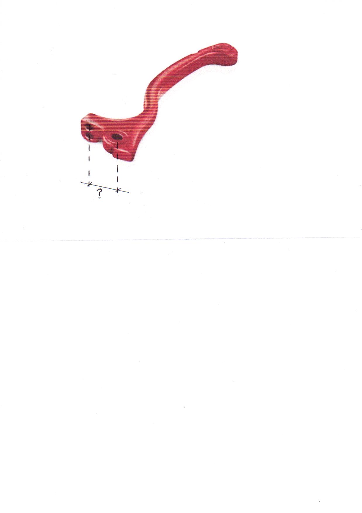

I've done some measurements and the distance between the pivot hole (for the mountinhg bolt) and the pin hole that works onto the back of the master cylinder can vary by 2 - 4 mm. Does anybody know which brand has the biggest distance here :?: . The bigger the distance between these two points the greater mechanical advantage you will get, so the clutch should be lighter, or you can get more pressure onto the front brake.
I've got AJP levers, Apico levers & V levers. As of yet I haven't bought any S3 levers.
I've attached a picture below for the measurements I'm looking for.

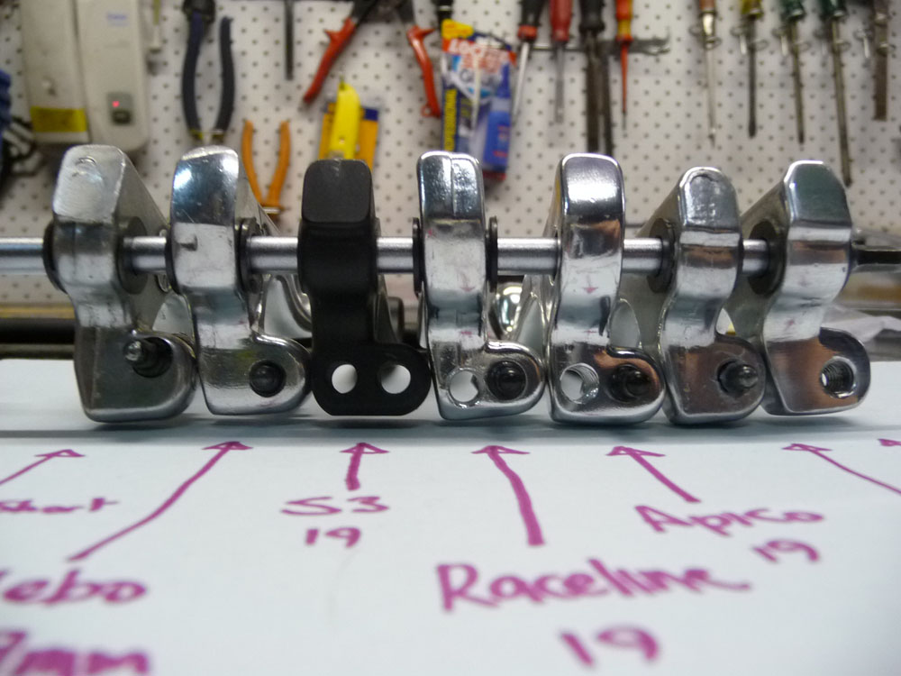

Hi Gary
Yes i have measured all these up about 18 months ago, and seem to remember the shortest ones were about 14mm and most were in the 16-17mm range , with i think the latest Scorpa SR levers having the biggest mechanical advantage.
I'll drag out the info when we go back and let you know.
Do you want drop pin (gg) or straight pin (sherco)?

Glad I document this stuff, the Scorpa lever had the shortest distance!
