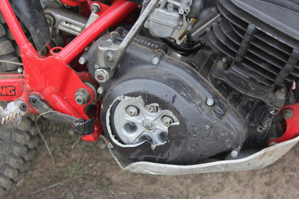

Shame I didn't have one on my recently finished TY350R after it went skyward, on a hill climb, then over my shoulder and then landed on its wheels before shooting off downhill before launching off a drop off and landing square on its side and smashing the clutch cover and basket !!
Funny thing is I had a Leonelli magnetic lanyard kill switch in my spares box!!! Didn't do me any good in there eh !!
