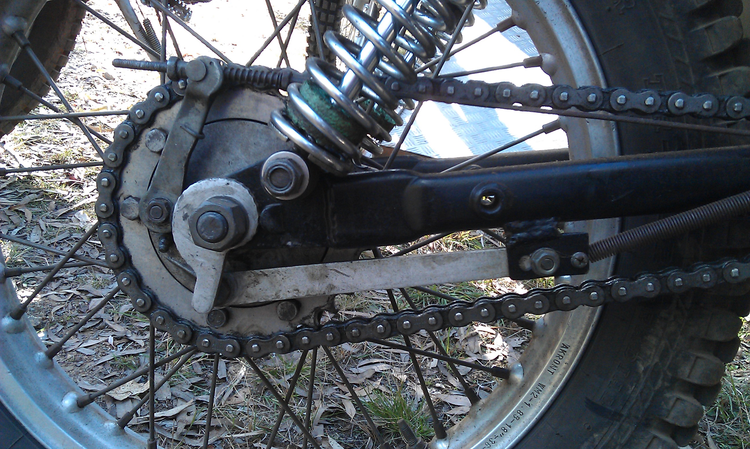

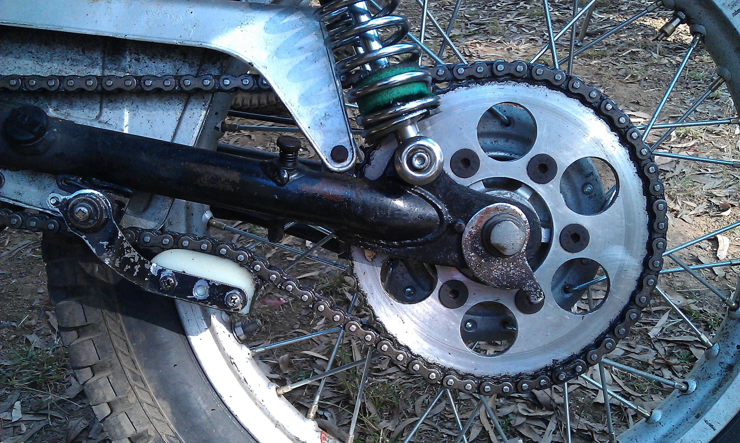

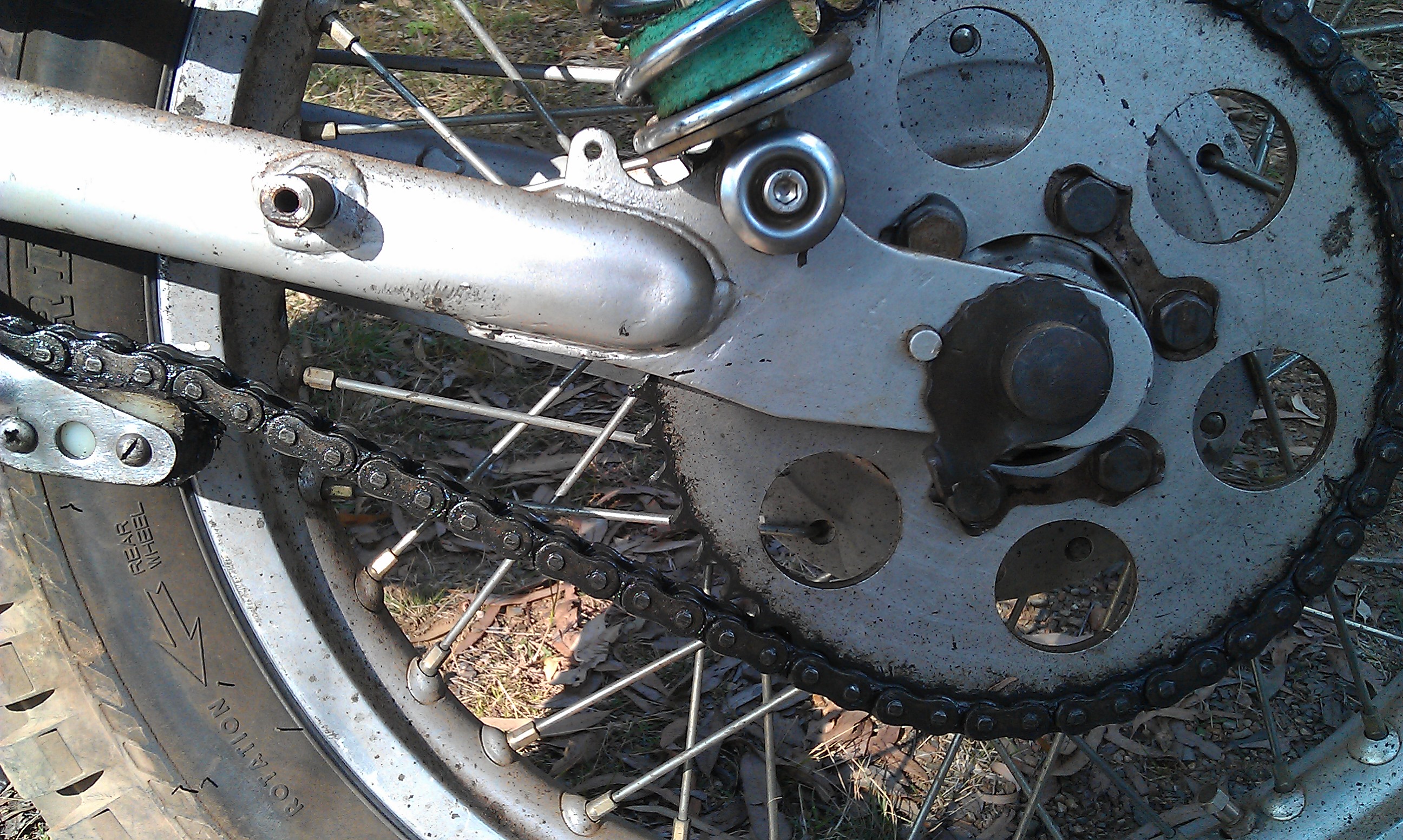

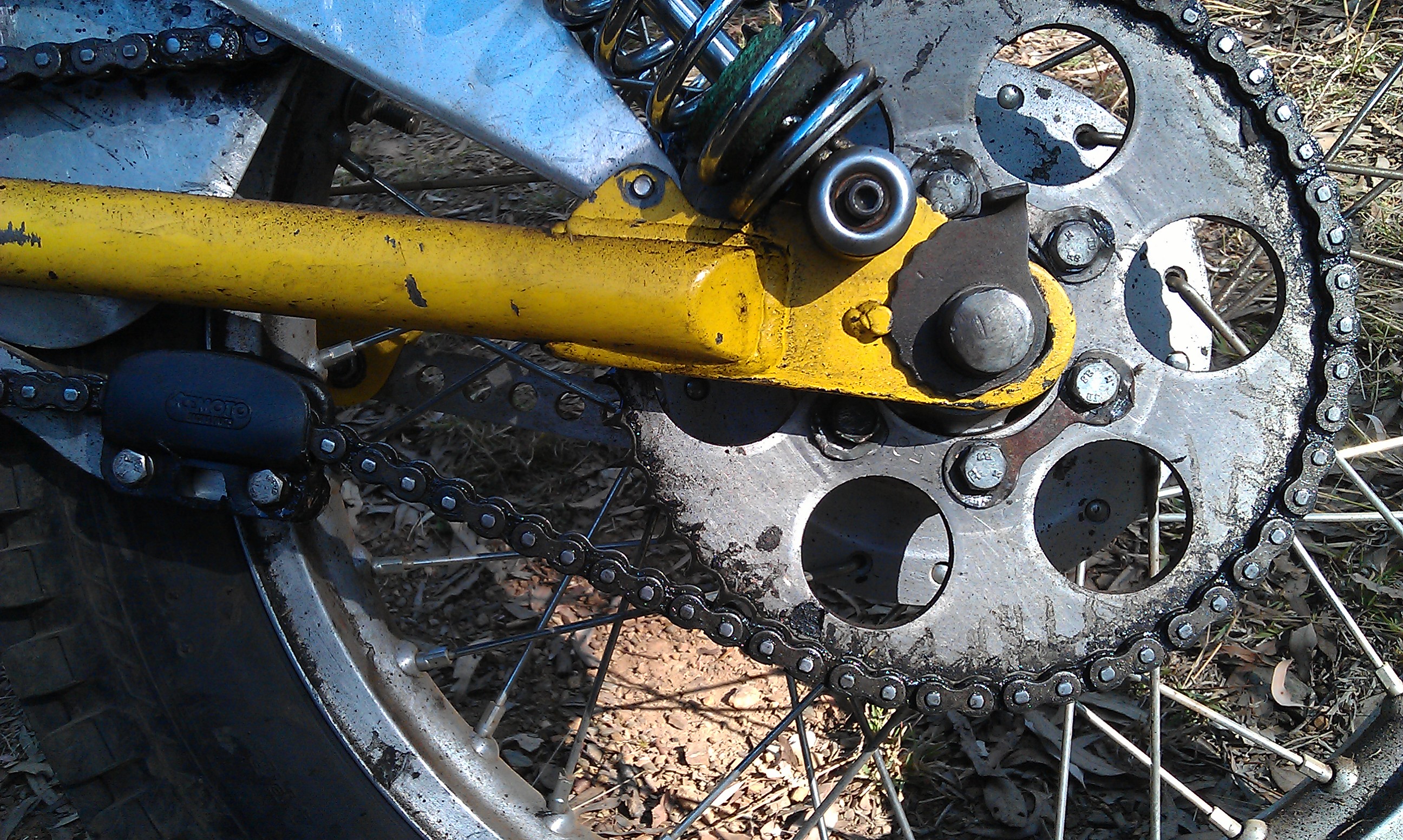

The Cota 348 has just gone up a few rungs on my popularity stakes because it will be a breeze to fit a sprocket guard, compared with the others

I'll vote for the 348 if its not too late, mainly because I'd like to bludge a bit of a ride on it
The 49 is pretty easy to fit too and would love those rocks

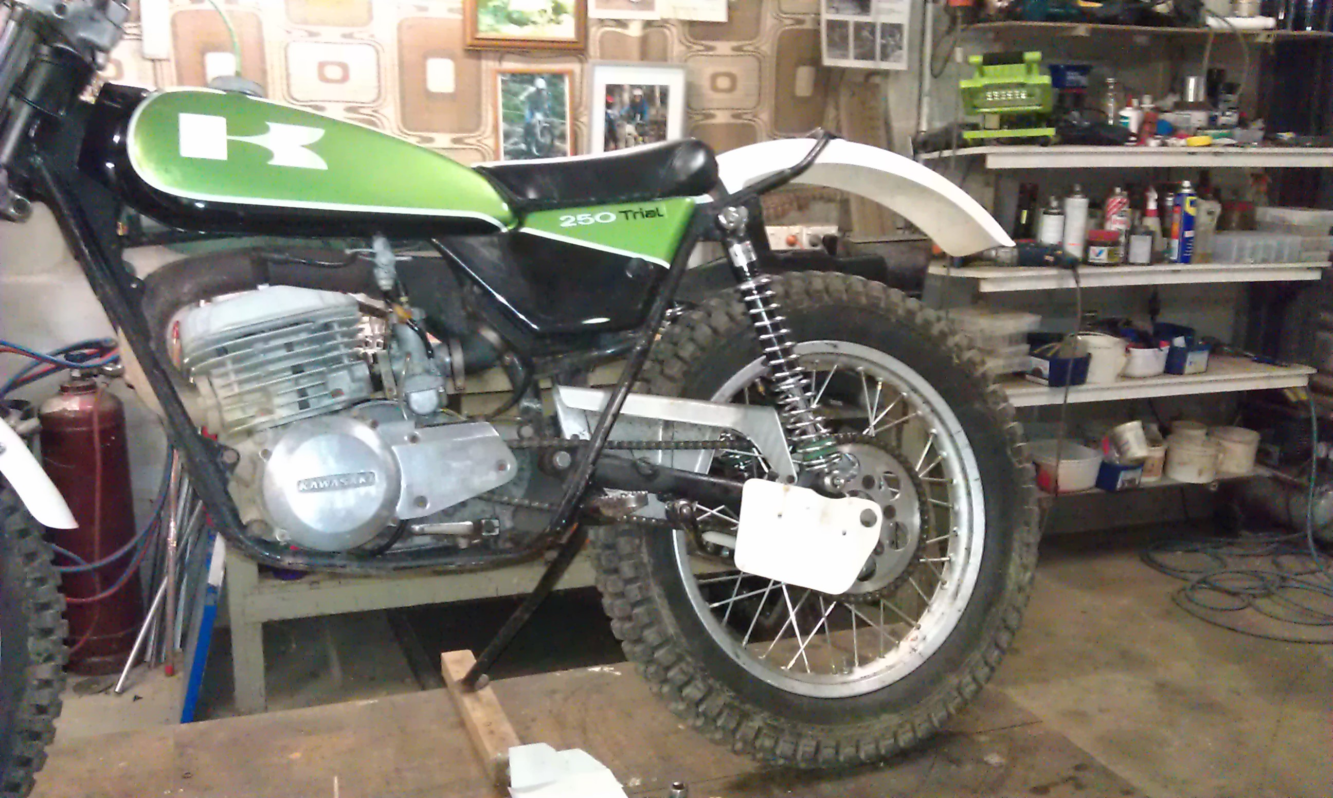

Does my bum err.... sprocket guard look big in this?

I think that guard deserves a spot in next years Mom's. But I'd hate to see the guard you make when you have to cover your valve stems?
