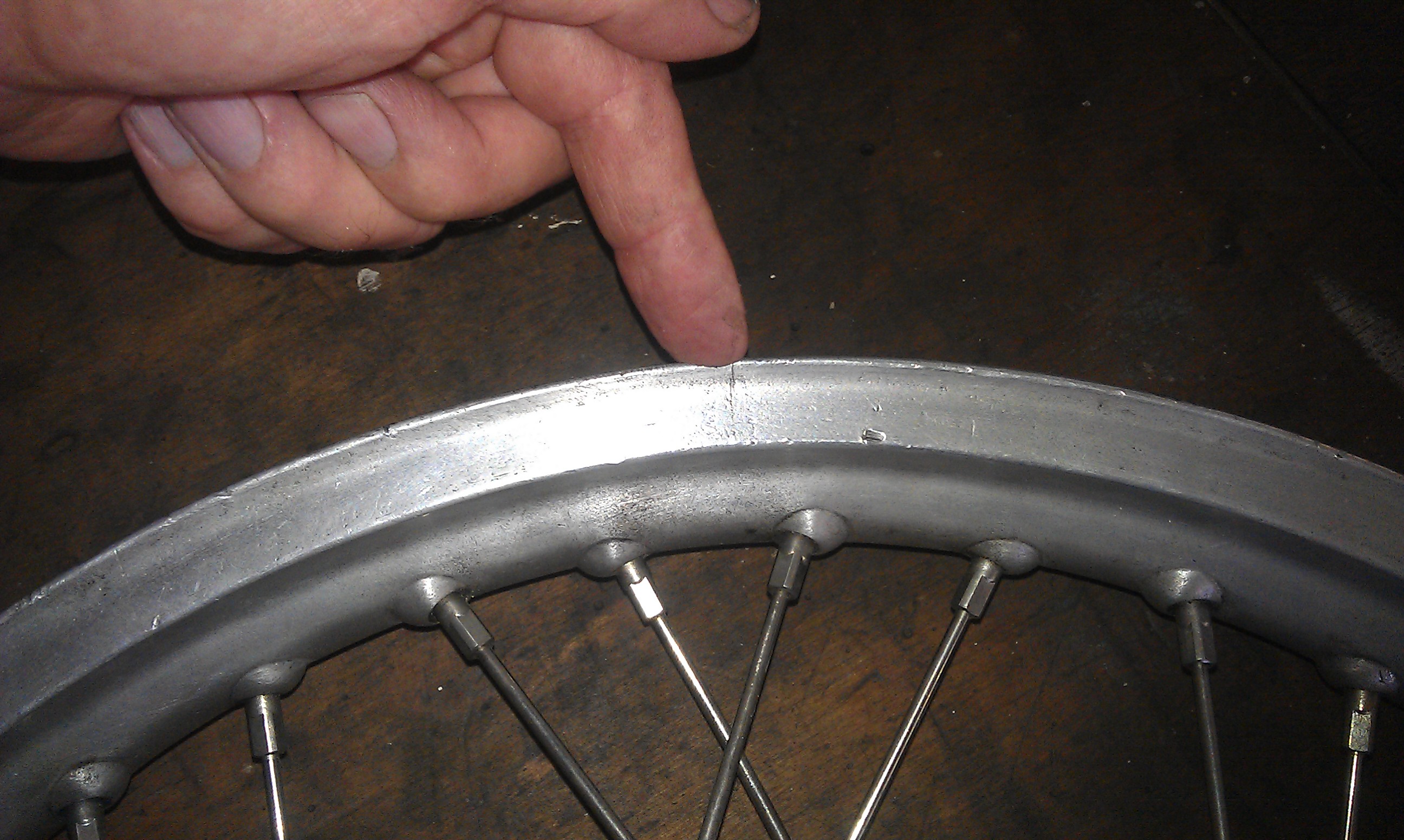

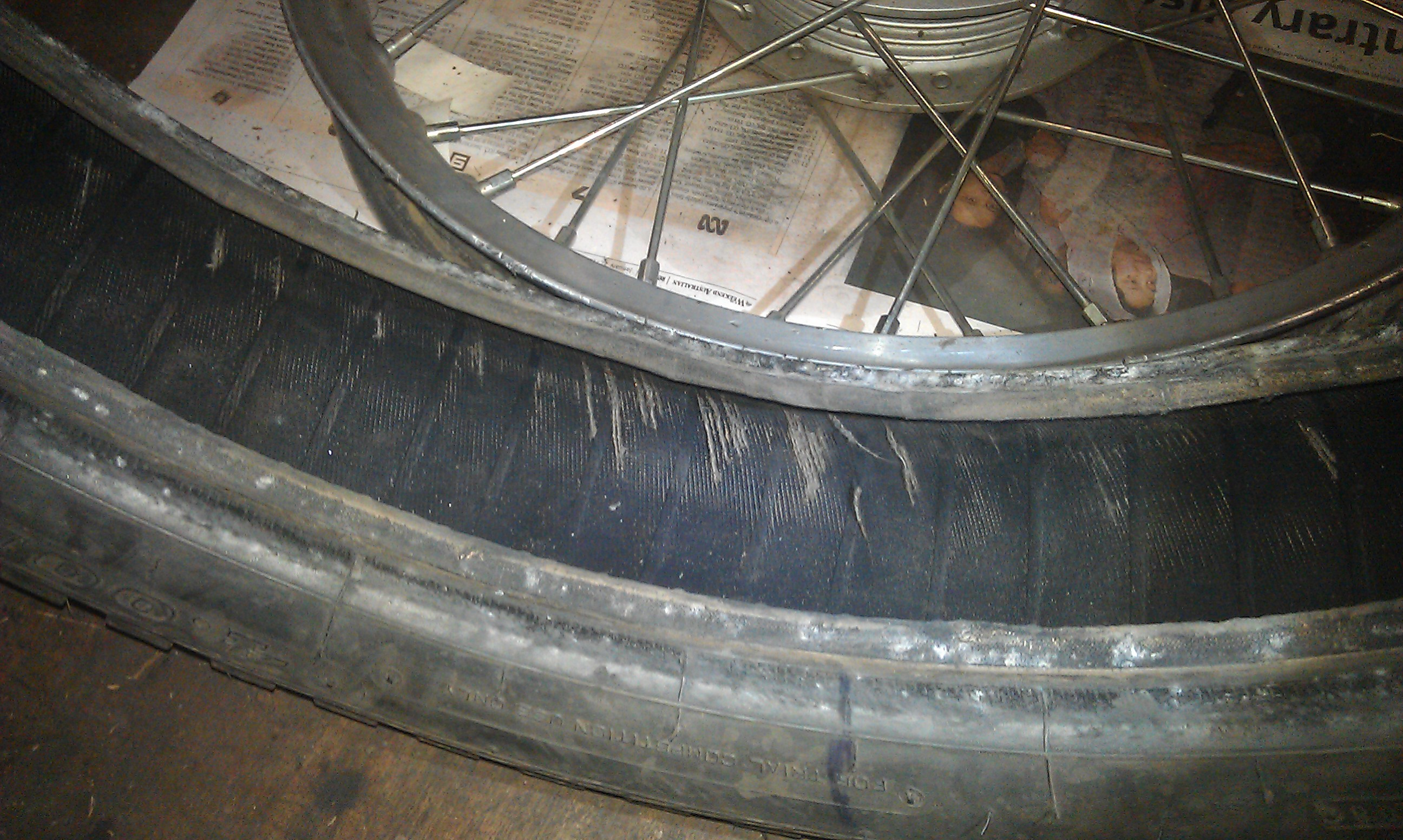

The first thing that happened was that the IRC rear tube type tyre that I had on a TY250D rim suffered a strange failure with the tyre cords in one location pulling out of the carcass, which rubbed through the tube and gave me a flat. When I took the tyre off I noticed that there was a crack at the rim weld. The third thing is that for the past 6 - 12 months I have not been able to source any more new IRC tube type rears.

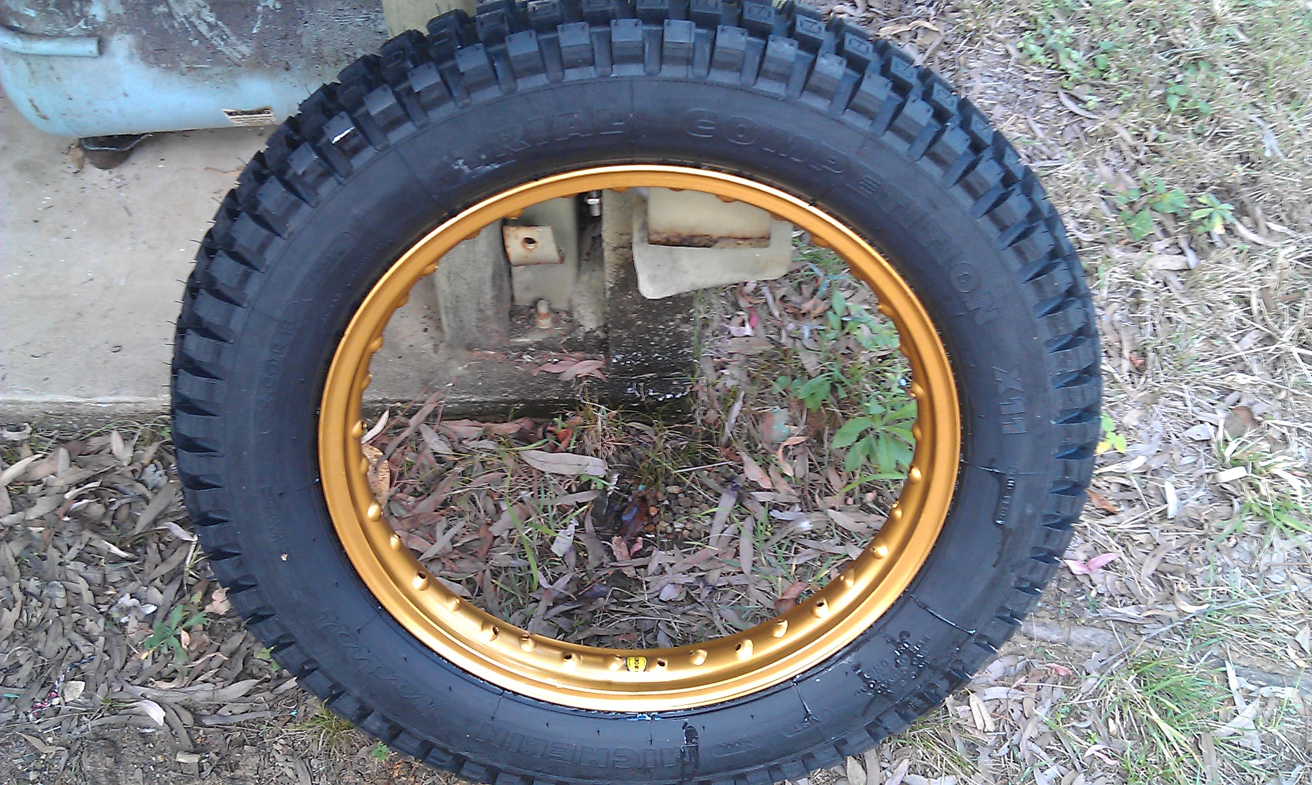

So four burst inner tubes and a few hours of upper body exercise later, I have found that Greg and Tricub are both right! Of course an easy thing for me to do with the wheel with the cracked rim, is to fit a TY250A rim, but I only had one of them available and there are a few other bikes that will eventually need to use Michelin tyres unless IRC starts selling them again. I used the cracked TY250D rim to experiment with for the bead seat reshaping, and after a few tries, the tyre stayed on the bead seat at trials pressures when tested on my practice sections this afternoon. I already tried the tyre on the TY250A rim last weekend and it stayed on the bead seat in the workshop even when I let the pressure right down, but I didn't ride with it.

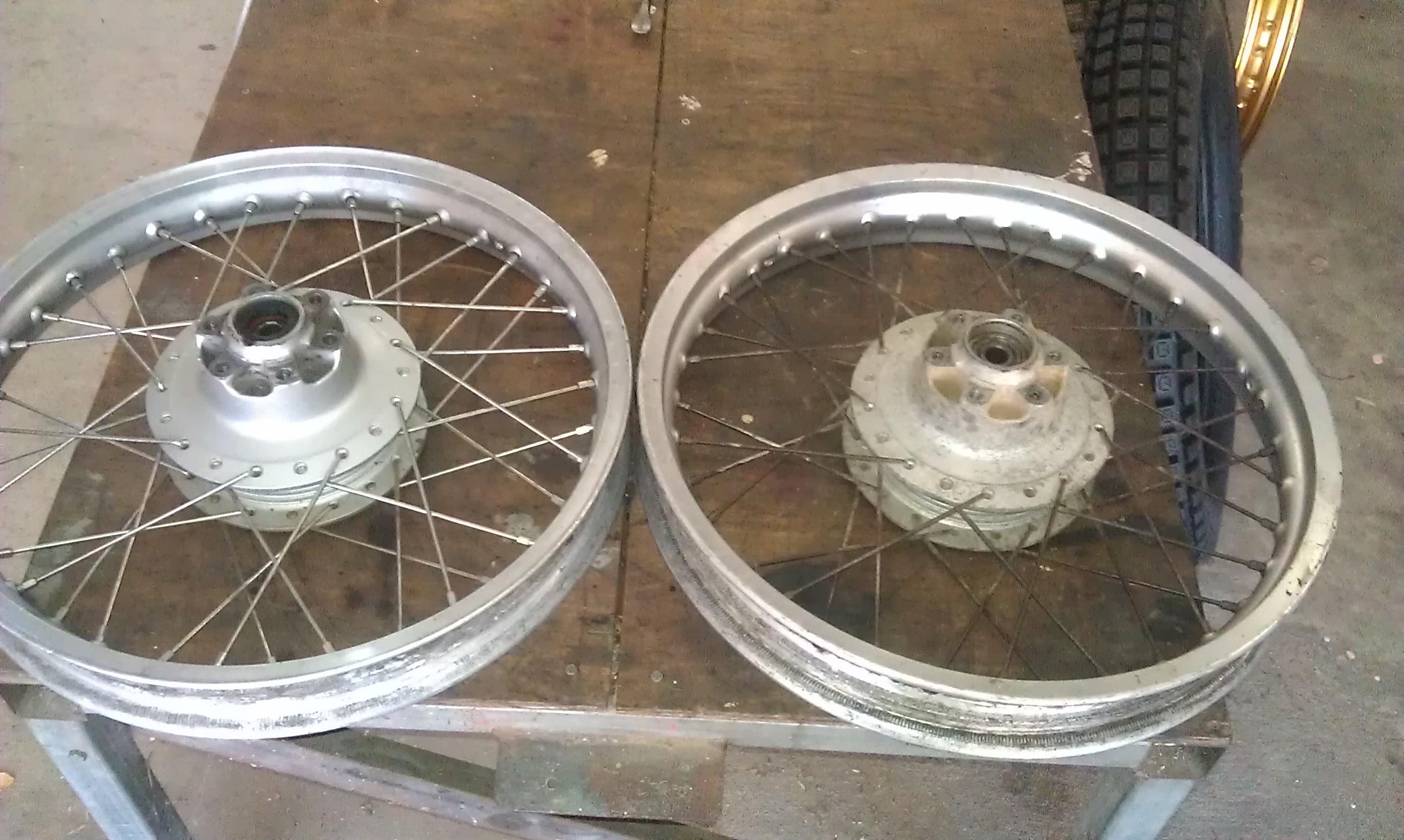

The bead seat on the TY250A rim is 11mm wide and has a sharp corner. I think the wider bead seat on the TY250A rim may be why the tyre stays in place on this rim, but the TY250A rim is also about 12mm wider than the TY250D rim, and this may also play a part in why it works.
