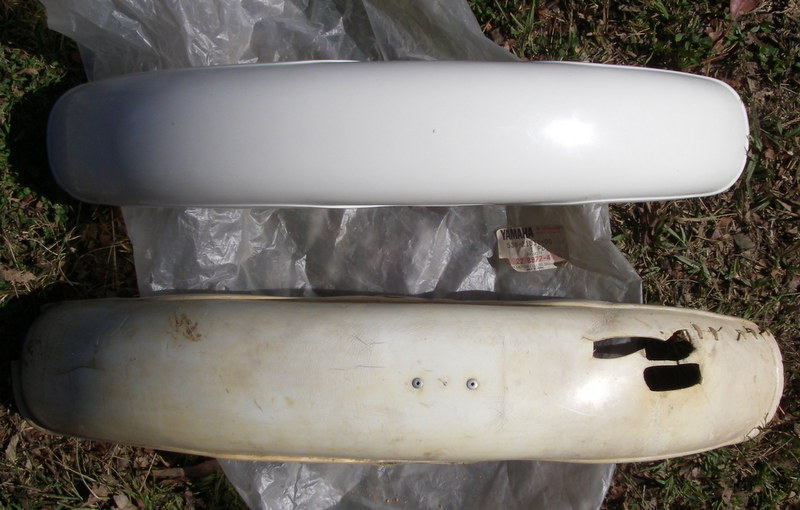

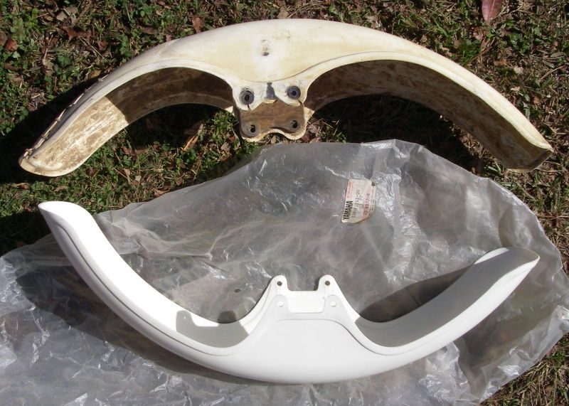

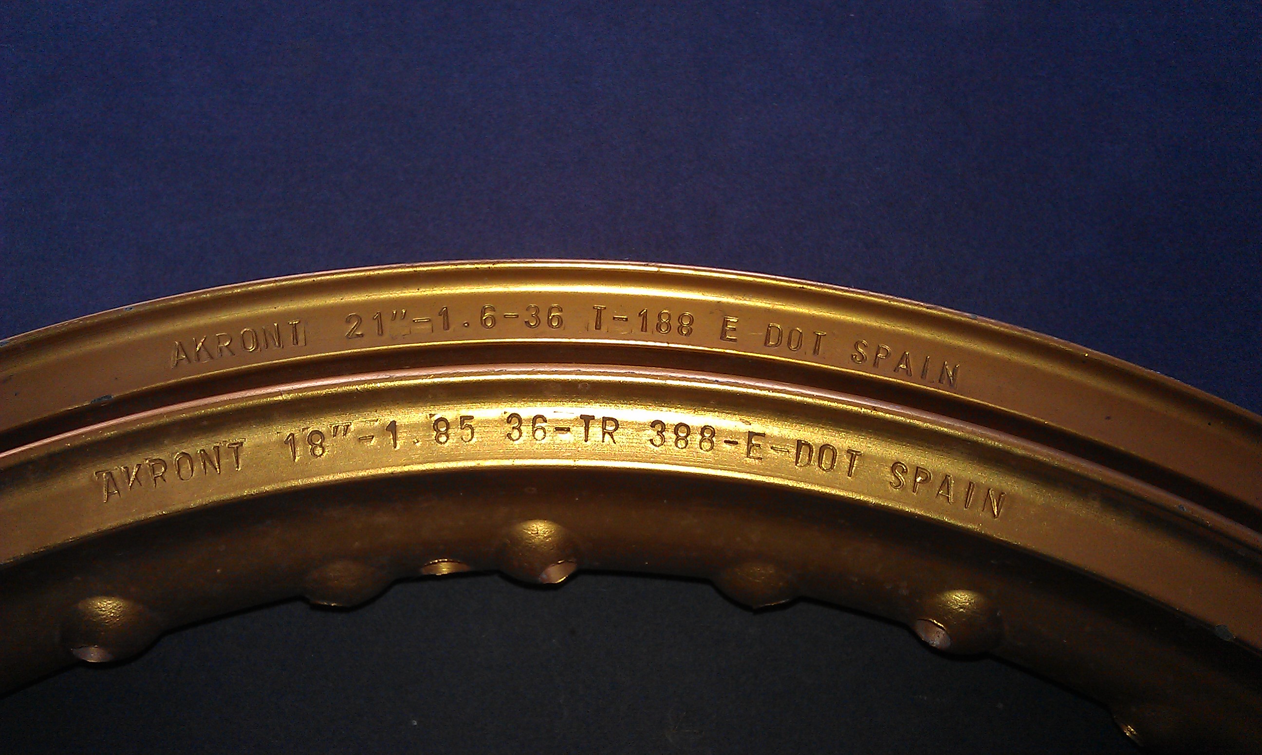

David, front - March 1983, rear - July 1981 you say, do you think that makes it a 1983 model and they used old stock rear rims? Also you were right again with regards to TY NOS front guard, it is not for a TY175/250, so must be TY80 bigwheel. Don't have any use for it yet!

Hello Greg. There is TY front mudguards available in Australia from VMX Unlimited for $64.95. They have gone up in price since the last person I put on to them but I suppose that happens. Have a look on their website. The mudguards are a close copy. Graham.
Yes Greg I reckon you are right with your 1983 date for the Italjet based on those rims. Here are some similar rims purchased new in 1988 from the UK, and seeing yours and these was why I think that the stampings just before "E-DOT-SPAIN" indicate manufacture date

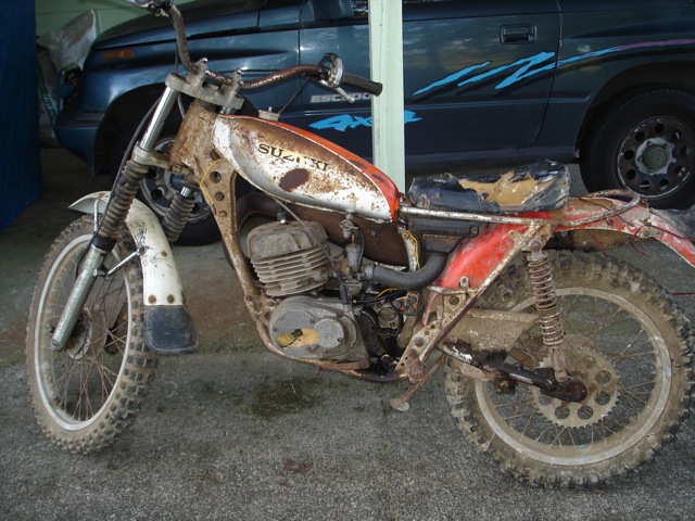

Hi All, Couldn't help myself. I blame alcohol, the internet, and a credit card. Next Project - what a piece of s**t
. Will finish KT first cheers Ross

Ross, love your photo of RL250, it oozes potential and patina! Bet it could tell some stories
Your interest in Suzuki's is not limited to just bikes, what year model is the Escudo?

hi all, Greg - i thought it was rather subtle to have two suzuki's in one photo. The Escudo is an ancient 1991, but the 1974/75 RL250 replaced a 1961 Morris Minor. I think i may have some problem with liking old things

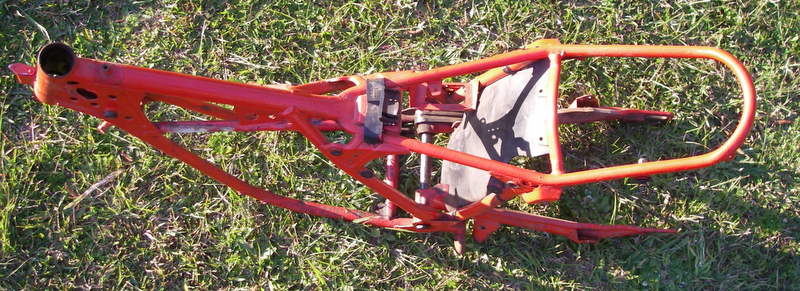

Just sharing where we are up to with the Italjet, back to bare frame ready for Steve to paint.

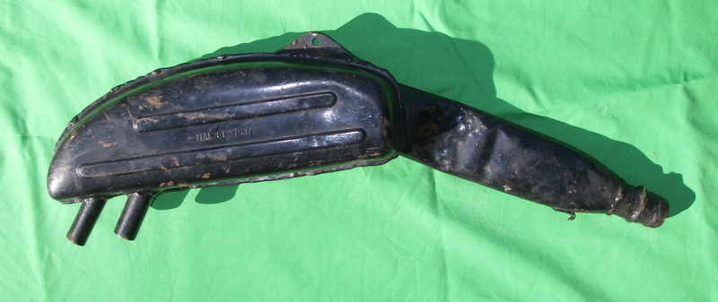

Thankyou Mick Chadwick for the elusive rear silencer, Steve has burnt out the carbon and bead blasted ready for me to repair the dints behind the shock.

Geoff, as you said there is a couple of cracks in the frame, midway down the back edges of the headset gussets which are a little thin.

Hi Greg, Check the swingarm for twist as well, and the bottom , under engine tubes, if they are flattened the headstem gets more raked out. Good luck. I was quoted $1300 to jig and have my frame checked! OOPS! Needless to say I didn't bother and went by eye, which works much better after beer!
