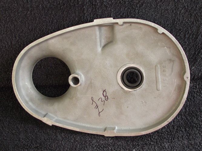

Hi Geoff, lower plug lug, drain. one on left lug, fill level. ( In the pic, the bolts are not Tapped. )
The oil is flicked onto the clutch plates by the chain, as they come out, when you pull it apart, with oil all over them.
