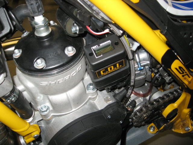

Here is a great little hour meter that fits easily to your trials bike.
Why have a hour meter ? To keep track of how many hours between your last oil change, airfilter change, or engine refresh.
(Ossa owners will know their ignition records the running time automatically, but it looks like being some time before all trial bikes go EFI)
The hardest part of fitting a hour meter is normally finding somewhere flat to mount it.
The solution shown here is to stick it on the ignition module, using a piece of Velcro strip. I find putting the male Velcro piece on the meter and the fuzzy female part of the Velcro on the ignition seems to work best, for those occasions when you want to take the meter off to wash the mud from parts etc.
Supplied in the packet is the pickup wire, which needs to be pushed into a slot in the back of the meter, and wrapped around the spark plug lead just a few times to pickup the engine pulse. You will need to use only part of the cable supplied, just cut off what you need.
pickup mod.JPG (120.31 KiB) Viewed 39729 times
fitted mod.JPG (142.59 KiB) Viewed 39729 times
meter mod.JPG (90.91 KiB) Viewed 39729 times
