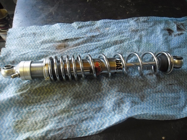

Does anyone know what oil quantity and pressure to run in Betor shocks?
I have just rebuilt with new rod seals, and have tried 50ml oil and 40PSI but have to much "race sag"
I was unable to measure how much oil and pressure from STD as it all leaked out.
Any help appreciated.
Shocks are for a TY they are Betor 40LBsprings 360mm centres.

I think I have got them to a reasonable quality, less oil more air pressure, 30ml 10W oil 50PSI air, screwed the preload up so under the weight of the bike (TY175) they sag about 10mm, my theory is that I only just have enough spring tension combined with air pressure to return the shock to its full extended length whilst holding the bikes weight, the shocks bottom out when I really bounce on it hard, the dampening seams improved (maybe this has something to do with the weight and quantity of oil), they are noisy buy, you can really hear the oil doing its thing. Any way I will try them on a few sections next trial and see how they perform.
If any one knows the original oils quantity and pressure be sure to let me know.

40psi is not enough pressure to run betors, try 60-70psi, how are you charging the shocks? You need to be using a charging chuck otherwise you are wasting your time. A clip on or screw on valve will drop your pressure off without you even realising.
The seal type used in betors is high pressure, no compressive spring, without high presume it will leak
