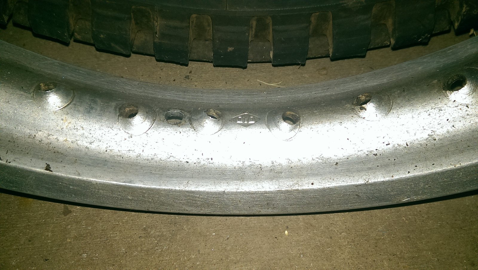

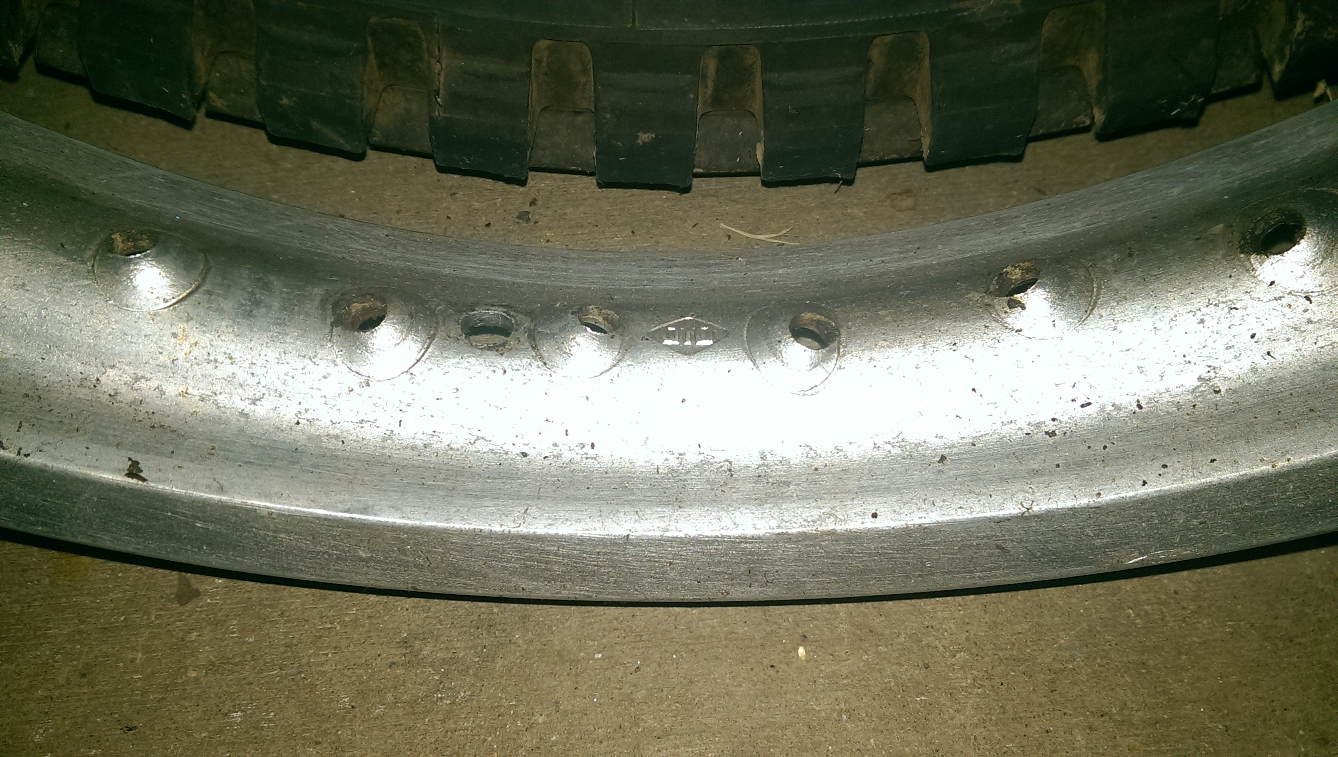

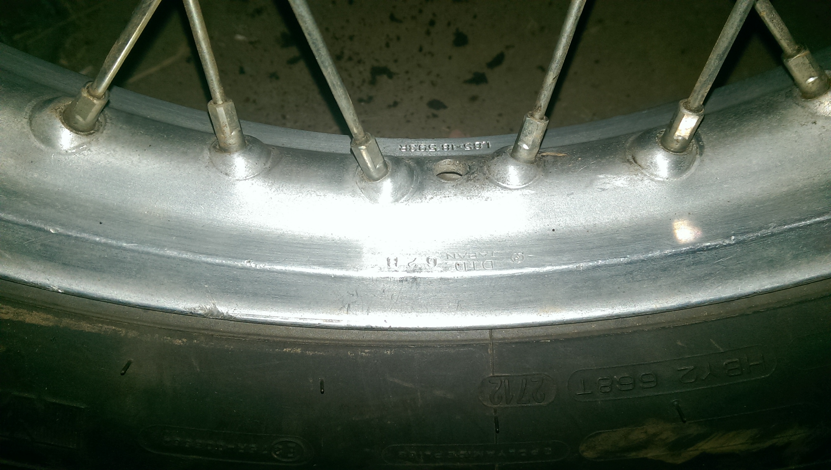

Can anyone tell me what the difference is between an A model set of rims and a later twinshock TY?
Wondering if the following rims could be used with 'A' hubs?
http://www.ebay.com.au/itm/YAMAHA-TY250 ... a94&_uhb=1
TY250A Rims
Re: TY250A Rims
All the Ty twinshock bikes had the same hubs so any rim from any model will fit A model hubs.
The rear rim on the A model is a fair bit wider than the other TY250 twinshock models (and is a different profile) so the bike will look a bit different if you use a CDE model rear rim. I can do photos if you want
Re: TY250A Rims
Hi David, great info thanks!
If you have pics that would be interesting....
