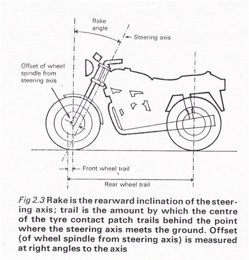

Let’s start with some basics. A picture is worth a thousand words:
Rake, Trail, Offset 2.JPG (44.08 KiB) Viewed 25265 times
All diagrams courtesy Tony Foale; used with permission (http://www.tonyfoale.com/book/" onclick="window.open(this.href);return false;)

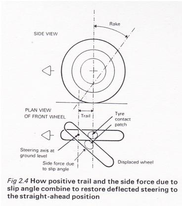

Trail is the distance that the centre of the tyre’s contact patch trails behind the steering axis. It (not rake) is the real factor which causes the self-centring (self-correcting, stabilizing) effect when in motion.
It works because anything that causes the wheel to steer left or right also moves the contact patch to the side of the steering axis so the friction force (from tyre on road) acting on the contact patch produces a torque about the steering axis forcing the contact point back behind the steering axis. ie the self-centring effect
The longer the trail, the longer the ‘lever arm’ & the greater the self-centring torque produced about the steering axis, ie the greater the self-centring effect.

Offset: The distance the axle is offset from the steering axis gives us the desired trail. Typically trail is inversely proportional to axle offset; ie more offset gives less trail. But perhaps just as important is the offset of the centre of gravity of the steering mass, for that is the point through which gravity/weight & centrifugal force act to affect steering.
These offsets may or may not be the same. Yokes that ‘kick-out’ the forks a couple of degrees & sliders that have the axle offset in front of them reduce the offset of the C of G of the steering mass compared to parallel yokes & sliders with in-line axle, which is a good thing (see later).
Trail = wheel radius x Tan rake angle – offset/Cos rake angle
Rake - ie the angle of the steering axis measured from the vertical. Yokes (triples) that ‘kick-out’ the forks a couple more degrees than the headstock have many benefits but they do not change rake because they do not change the angle of the steering axis.
