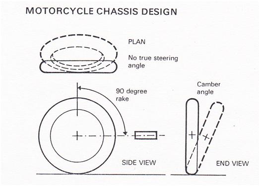

Effects of rake:
Perhaps the best known effect of rake in trials is that steeper rake gives quicker or ‘sharper’ steering. This is because with less rake, the angle you steer the bars corresponds more closely to the angle the front wheel steers. Consider zero rake (vertical axis): the angle you steer the bars is exactly the same as the wheel. But for 90deg rake (horizontal axis), it doesn’t matter how much you ‘steer’ the bars left or right, there is zero degree of steer at the wheel; the front wheel just leans instead.
All diagrams courtesy Tony Foale; used with permission (http://www.tonyfoale.com/book/)
It’s a simple relationship of trigonometry: the steering angle of the wheel = the steering angle of the bars x the cosine of the rake angle. (Cosine 0deg = 1; Cosine 90deg = 0)
That is why the steering is more precise or ‘sharper’ with steeper rake – it is more direct, ie “quicker”. eg At 0deg rake the wheel steers 100% that of the bars; at 26deg rake it is 90%; & at about 36deg it is 80% & at 90deg it is 0%.
Or to put it the other way round; the more rake, the more vague the steering. Although this is the best known reason for minimizing rake on trials bikes it is not the only one.
Wheelbase plays its part here too. Obviously a shorter wheelbase allows tighter turns, which in a sense means quicker steering. “The path’s radius (ie of a bike when cornering) is directly proportional to wheelbase” (V Cossalter, Motorcycle Dynamics)
You can see in that diagram that a longer wheelbase requires a greater angle of steer for the same centre of curvature & the front wheel follows a larger radius of curvature (wider path).

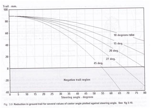

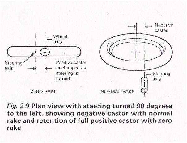

Effect of Rake continued:
There is another problem with rake; perhaps the worst of all. As we have seen, when you turn the bars, rake transitions into camber so that at 90deg steer, a bike with 26deg rake (eg) would effectively now have 26deg camber & zero degree rake (in the direction it is steered). Worse still, whatever axle offset you started with now puts the tyre’s point of contact with the ground that far ahead of the steering axis.
All diagrams courtesy Tony Foale; used with permission (http://www.tonyfoale.com/book/" onclick="window.open(this.href);return false;)
So positive trail has reduced to zero then turned into negative trail as you steered. Hardly ideal! You can feel this transition when riding as the front end wants to turn-in further or tuck-under when the trail goes negative.
If the bike had more trail the transition point (to negative trail) would be closer to 90deg steer where it’s less noticed. But if it had zero rake, the trail would remain constant no matter how far you steer the bars right or left.
So the steeper the rake the less this reduction in trail as you steer & the closer you get to 90deg steer before trail goes negative. Since trials bikes so often operate at extreme angles of steer, this is perhaps one of the foremost reasons for steeper rake on modern bikes. But it must be remembered that in designing for steeper rake, offset must also be adjusted so that you still have an appropriate amount of trail for the steeper rake. If you don't, tucking under will likely get worse because of insufficient trail.
It is possible at the design stage, by minimizing rake & optimizing trail, to ensure that trail does not go negative at any angle of steer. See Fig 3.9 below for a road bike (89mm trail, 61cm dia wheel). At a typical 27deg rake, trail reaches zero at 67deg of steer & beyond that, goes increasingly negative. But at 20deg rake it’s delayed till almost 80deg of steer. And by the look of it (if you extrapolate the graph) at 15deg, trail wouldn't go negative at all on this bike.
But please note: They all start with 89mm trail at zero steer angle. ie the offset has been adjusted to maintain the same trail at the different rakes
However with most motorcycle set-ups, including twin-shock trials bikes, the self-centring effect disappears completely at some angle of steer & the tuck-under effect gets worse the further you steer beyond that transition point (ie the closer you get to 90deg of steer).
Ironically, the ‘quick fix’ for this is widely regarded as to “give it more rake”, perhaps because it’s easy to do; eg fit shorter shocks. That works to a degree, because of the extra trail you get with more rake. If you start with more trail the point of transition moves closer to 90deg steer where it’s encountered less often, but it is really a case of one step forward (more trail), half a step back (more rake, which is counterproductive). Ideally what’s required is more trail with the same rake or (better still) less rake with the same trail.
When modifying older bikes, especially those in the lower margins of trail, reducing rake while keeping the same yokes is often fraught with this problem. The reduction in rake would improve it, but the associated loss of trail seems to have more noticeable effect & the overall effect is that tucking-under becomes worse (ie occurs at lesser angle of steer).
This tucking-under effect is probably felt more by non-stop riders than by hop-stop riders
