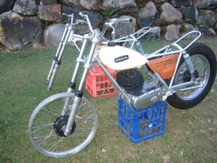

I have had some time to do a little on the Ossa "twins". That being an
Mar 250 and Mar 350. Now isn't that a challenge, especially when 90 percent of the parts came to me completely pulled apart. These do really fit the bill of "Basket Cases".
As you have said David, somewhere in Australia, there has been a wizard casting some magic back into these
motors and has done some superb machining.
Here are some progress photos for everyone and I have just sat the 350 motor cases in the frame to check there are no problems.
I spent a bit of time with the front wheels, but I am having trouble with the spacers on the axle. I can't get the wheel in the centre between the forks. These are the problems I face when bikes come in peices...... I also notice that both fork sets I am using are different. The lug on the bottom of the fork leg sticks out more on one set compared to the other. The lug locates on the brake backing plate.

Well Greg you like to tease us don't you. A partial photo!!!! At our last ride against each other we both rode
KT's on some tough sections, but very enjoyable at Thunderbird Park. Of course I was concerned at times about damaging the nice paintwork on my KT. David, I liked your acticle in the latest VMX magazine and Greg and my Juggernaut challenge at Easter time. My Italjet Scott 4 stroke is currently in hybernation for the winter....no I broke the kickstarter shaft and until I get time after doing the Ossa's, it will have to wait.
Mar 250 and Mar 350. Now isn't that a challenge, especially when 90 percent of the parts came to me completely pulled apart. These do really fit the bill of "Basket Cases". As you have said David, somewhere in Australia, there has been a wizard casting some magic back into these
motors and has done some superb machining. Here are some progress photos for everyone and I have just sat the 350 motor cases in the frame to check there are no problems.

They look fantastic Chippy. Can you do some close-up photos of the brake lug problem? Did you sort out the chain tensioner/brake rod issues?
