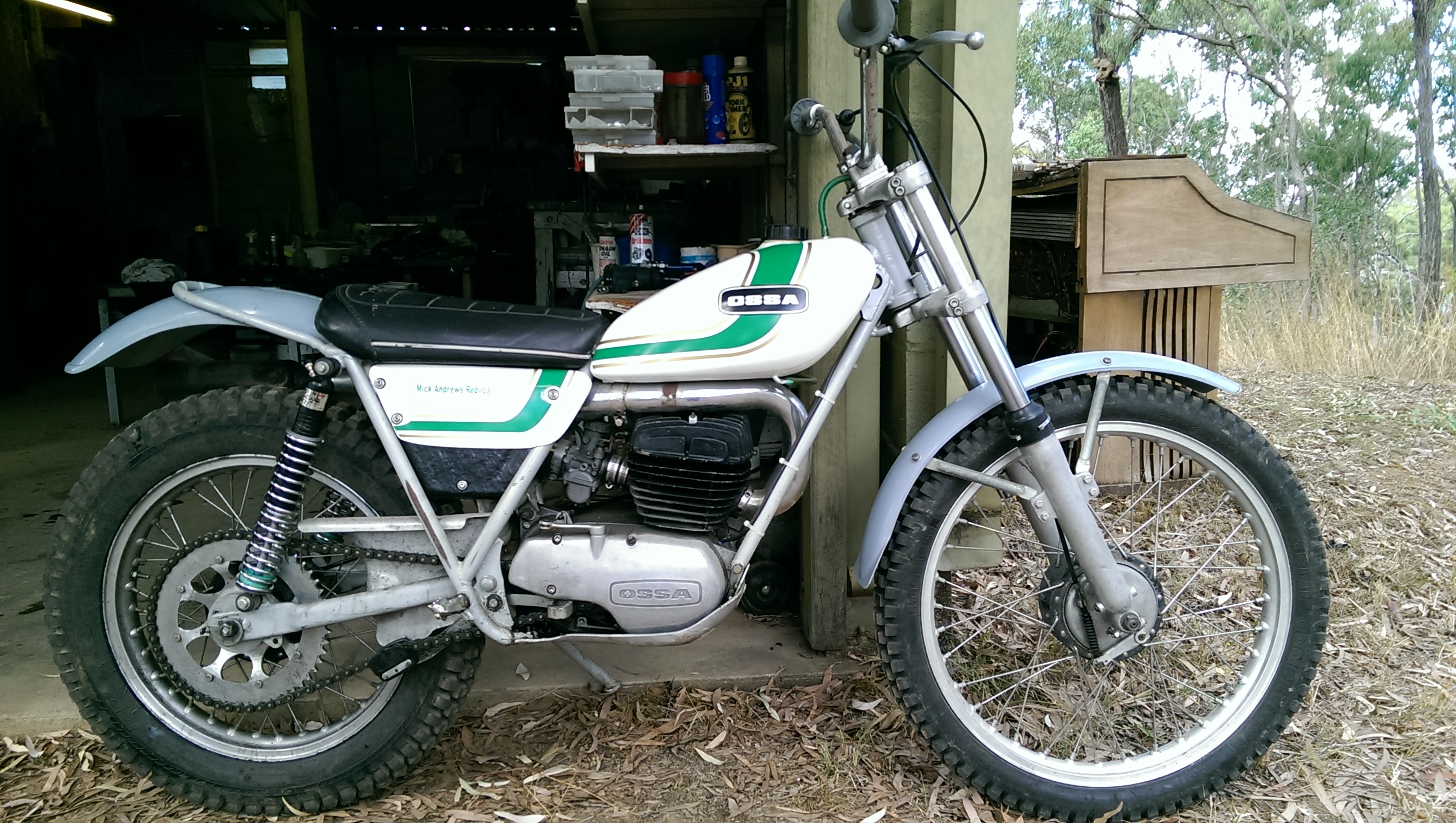

I have made some progress in getting mine ready for Conondale. This photo was taken yesterday when I had a test ride. Luckily I had drained the fuel tank and carby before storing the bike years ago, and all I did to get the motor running yesterday was to tip in some premix and start it! It fired on the second kick, and ran on the third kick. The clutch was stuck though and required taking the clutch cover off to free it up. After riding it around my practice sections, I remember why they were regarded as the "superbike" of 1972 when they first came out.

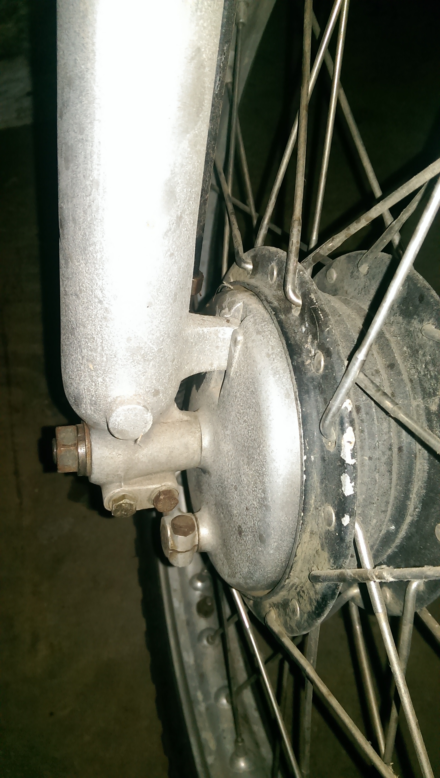

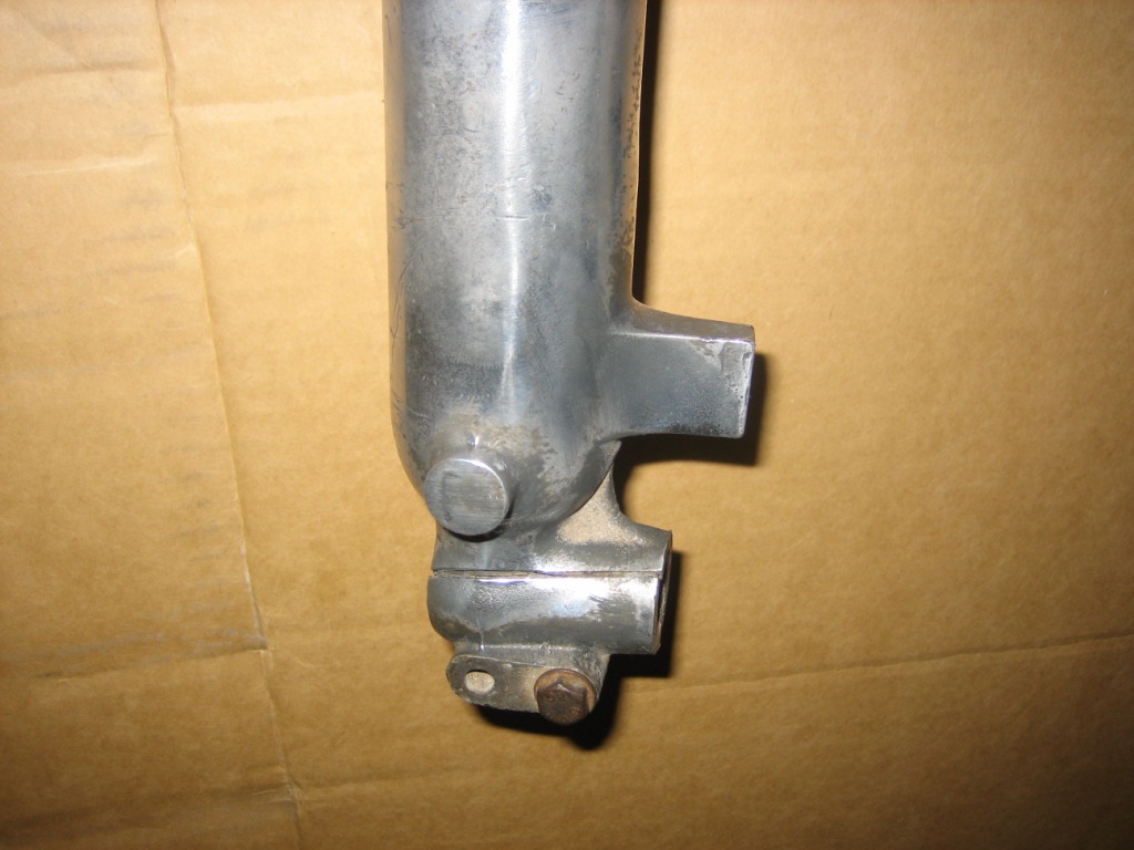

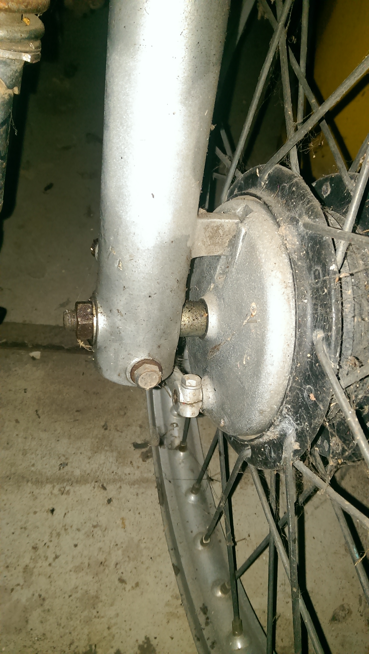

David, I have got some photos for you regarding the front wheels. I really can't sort out the correct spacing for these wheels. Can anyone help me?

Chippy I can't be sure from the photos but the photo with the square-bottom forks it looks like you have the fork legs opposite sides to normal. The backing plate should be on the RHS of the bike.
I'll check mine out when I get home for other differences

Andrew that fork bottom looks like it's had a hacksaw taken to it? Your welcome to have a look at the front of my bike if you get stuck. Don't think those washer should be there, from memory the backing plate should go straight up against the fork.

Andrew, that 1st photo is a mk 2 right fork leg that butts up to the brake drum with no washers or spacers, the mk 2 had the wasted away bit at the bottom of the leg before it grows bigger again for the axle attachment.
The 2nd photo is of different forks possibly mk 1, don't know much about them.
Don't know much about mk 2's either other then what I've learnt on here and found on other websites, but I do have a complete mk 2 sitting nearby and I have a genuine parts manual with exploded views with all part numbers.

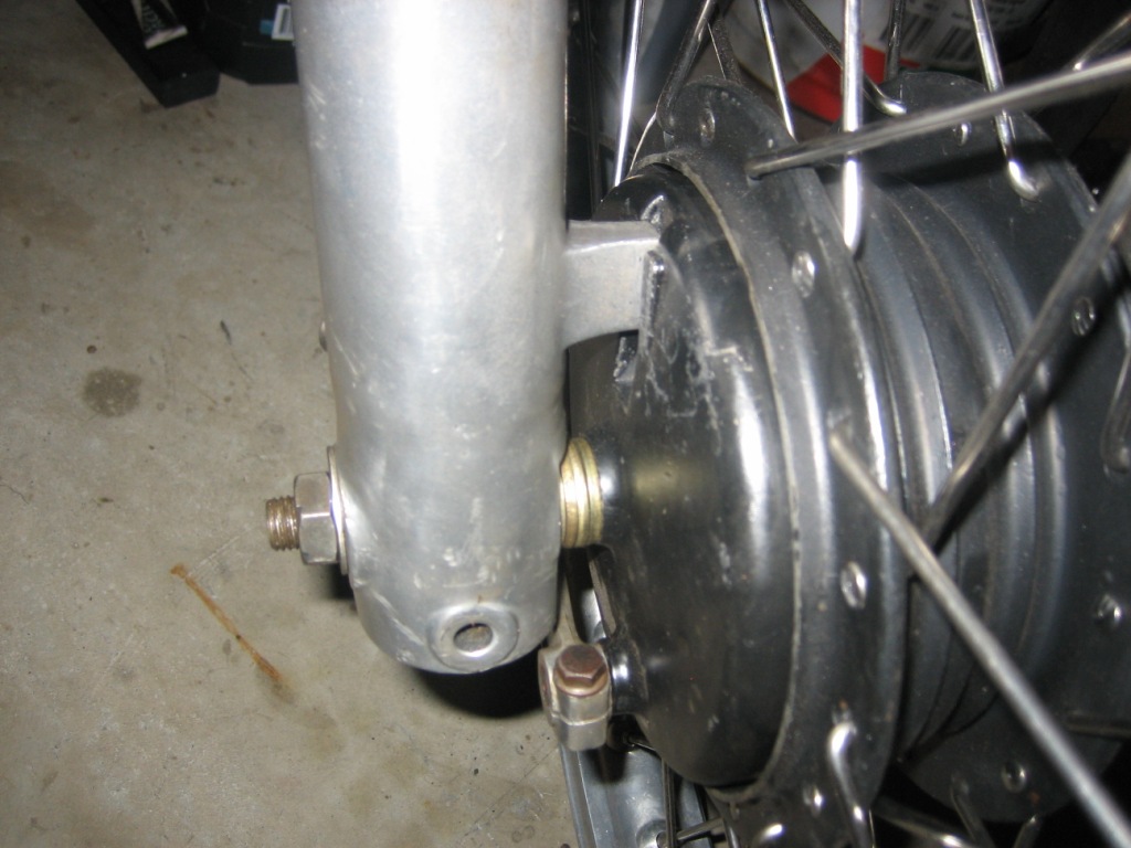

Here are photos showing both types of MAR forks. The square bottom forks ones have a spacer where your washers are

I may have sorted out the front wheel for the 350 with a 35mm gap from rim to inside fork leg on the both and the tang now sitting in the groove of the backing plate. However the other wheel has a narrow internal surface area where the brake pads are. It is only about 25mm compared to about 35mm on the 350 wheel I'm using. Tricub I might take you up on the offer re sorting out the wheels, just to check that I have it all correct. I just wonder if the wheel with the smaller surface area and only using 200mm brake shoes are off another model
like an explorer maybe?.
like an explorer maybe?.David, thanks for your help so far and the photo you posted of the early
