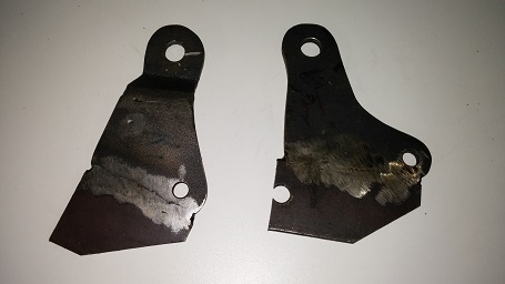

Why don't you make your own then you can position the pegs where you want them?
2014-08-27 15.03.15.jpg (30.79 KiB) Viewed 15398 times
2014-08-27 15.01.57.jpg (42.37 KiB) Viewed 15398 times
2014-08-27 10.17.56.jpg (40.84 KiB) Viewed 15398 times
