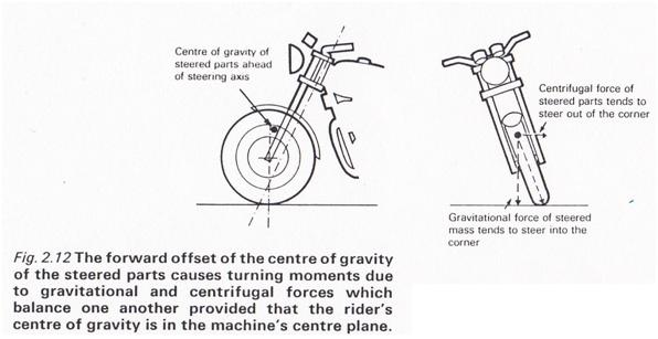

The effects of offset – There are two effects of offset of the C of G of the steering mass. The first, as we have seen, affects flop-in. The weight of the steering mass acts through its C of G (Fig 2.12), so the greater its weight or its C of G’s offset the greater the flop-in effect will feel (at low speed, leaned over), & the greater the force required to correct it & steer 'against it'.
But secondly, there is an opposite effect too (surprise, surprise!): ie at sufficient speed, with too much offset of the steering mass the bike can tend to steer itself out of the corner. The centrifugal force of the steering mass acting outwards through its C of G can exceed the gravitational force of weight acting inwards, forcing the steering mass outwards & steering the bike to the outside of the corner. It may not be called “climbing-out”, but that’s effectively what it is.
Although this is minimal in trials because of the slow speeds, it still could be a factor for non-stop riders because of the tightness of the turns. Centrifugal force is not only proportional to speed & mass, it’s also inversely proportional to radius of the turn (ie higher in tighter turns).

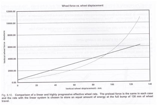

Effect of rear suspension evolution on steering geometry:
Rake had settled at about 26.5 to 27deg & trail at 80-90mm in the 60s-70s, then took a bit of a leap to 24.5deg on the TLR250 (with 78mm trail) in 1983. But with the intro of the TY mono (1984) there was a further jump to 23deg rake & it seems to have remained thereabouts.
One can see many good reasons for the reduction in rake, on account of its many advantages (as above) but I think there is another reason also.
It seems to me that some of the reason for the steeper rake & shorter trail is in the evolution of rear suspension & its effect on steering. The laden sag (with rider on board) with long travel rear (LTR) suspension of 160-170mm is considerably more at the rear than for the earlier shorter travel (90-100mm), while the front travel (165-170mm) and sag remained much the same.
The most important steering geometry of your bike is with the rider on board in his typical stance. On a classic/twinshock with 6-7” front travel & 4” rear travel, even with the rearward weight bias, laden sag at the front will most likely be more than at the rear so rake & trail in action are likely to be less than unladen specs on such bikes.
With the larger rear sag of the LTR systems when laden, it’s the other way around - rake & trail in action will be more than unladen specs. With the early LTR systems that weren’t much longer travel the changes were subtle & less noticeable.
By the time of Honda’s TLR250 with its considerable rear travel (160mm), the rake was noticeably steeper to compensate & the trail was at the shorter end of the existing range. Then when the TY mono arrived, with more progressive rising rate LTR suspension which was softer still in the initial travel (cf Fig 8.10), there was more rear sag still, & the unladen rake & trail required further reduction to compensate.
No doubt this alone does not make up all the difference in rake, but it surely is significant.
That being so, can a twin-shock bike without the same rising rate long travel rear suspension benefit from modern geometry? Surely careful consideration would have to be given to ensure realistic rake & trail when laden. It requires more than just changing the rake to match that of a modern bike.
