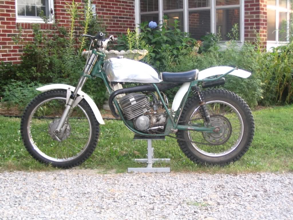

By contrast to the RL, look at this pic of a Greeves Pathfinder. The Puch engine has a very low countershaft sprocket, meaning the swingarm is almost horizontal, even unladen.
Greeves Pathfinder 2.jpg (187.29 KiB) Viewed 7830 times
That’s going to produce very little anti-squat even unladen at full extension of the suspension. In fact I wouldn’t be surprised if there was noticeable squat under power even with only a very light rider on board (ie with minimal laden sag).
