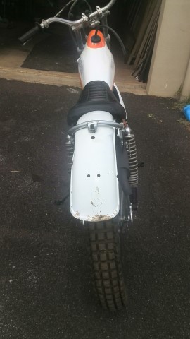

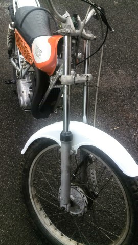

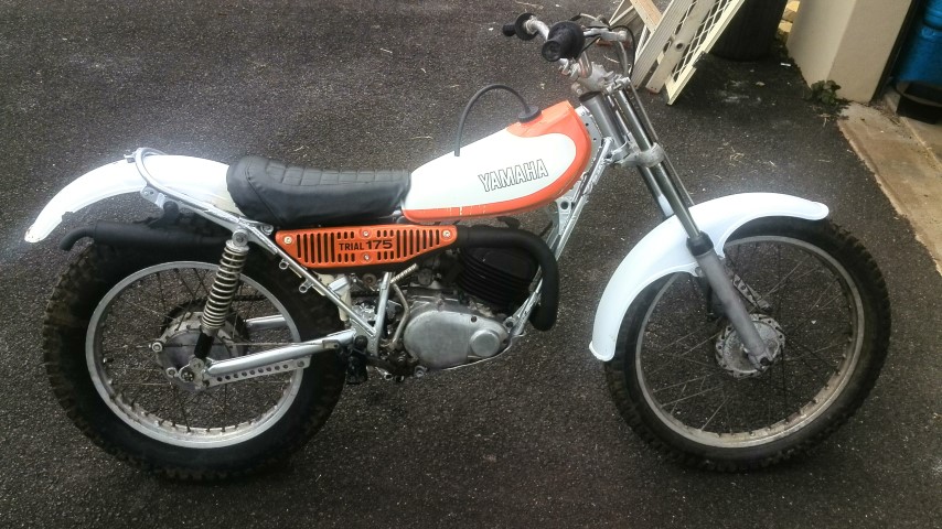

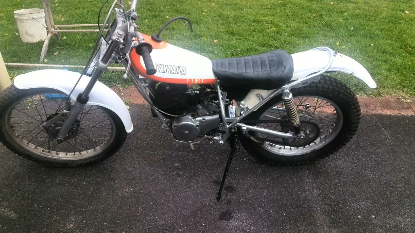

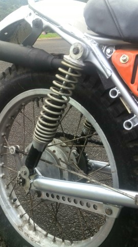

After deciding I wanted an old TY to learn to do trials on, I foolishly rushed out and bought the first TY175 I laid eyes on, and not being terribly bike-savvy (I've owned a few old bikes over the years, but haven't progressed far mechanically beyond cleaning an air filter), I may have rushed the whole *inspection* thing. So now I'm attempting to suss out if I've got a decent bike retrospectively.

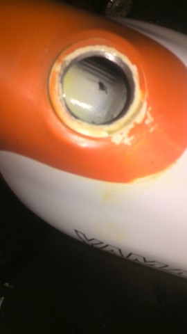

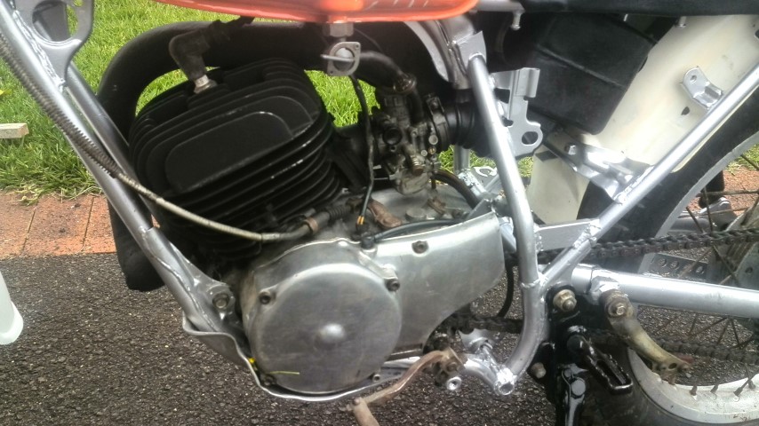

Here's a few pics. Apparently it hasnt been ridden much since a recent rebore piston and rings (have receipts). It looks like it's been tarted up a bit before sale. He gave the tank a nice lick of paint, but unfortunately seems to have used the wrong stuff, because as soon as a drop of petrol landed on it, it stripped it right off again. He even got a bit of overspray inside the tank, which is now proceeding to fall off, and i'm a tad worried it will wind up gumming up my carburetor.
It's missing one of the side cover things, which the prior owner is intending to get to me as soon as he digs it up.
So, how did I do?
Are there any other bits missing? Not original?
Also, what are the major things one should check/test when buying a used bike like this, so I don't wreck the damn thing. You'll have to go back to basics with me, for as I said - I am no mechanic!

See if you can get a toothbrush inside the tank and rub off the overspray inside, if it is coming off with fuel on it it should rub off easy. discard the fuel of course and rinse out with new fuel, a fuel mix of 80:1 should work well with but check with the manufacturers recommendations.

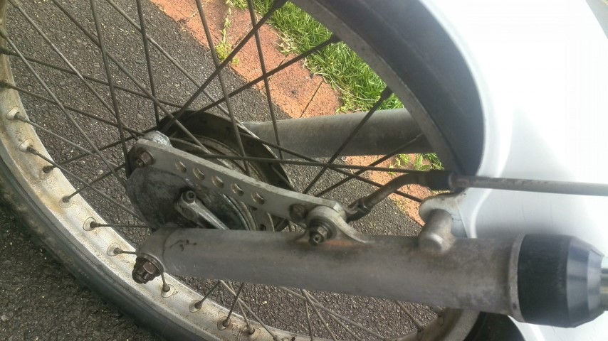

I suggest moving the fork tubes upwards in the steering clamps so that the top ends of the fork tubes are about 20mm above the top surface of the top clamp. That is the standard setting and the steering will feel nicer in turns than how the forks are set now.
The shockies look to be about the right length. They need to have a nice action and be balanced with the front forks to make it easy to ride in rocks. If you push down on the seat with one hand, the front and back ends of the bike should move down and up together.
When you put all your weight on the bike standing on the pegs, both ends should compress about half-way through their travel.
I see you have a TY175 B/C end muffler. The frame looks like a JC so your carby might be a TY175JC carby, which when standard has different jetting to the TY175 B and C models, and it is different because the JC model usually has a different end muffler and a rubber silencer on the airbox lid. The best test for the carburetion is to ride it and see if it runs well. If it goes well then no worries.
Gearing for trials is important. A 12 tooth front sprocket and 51 tooth rear is pretty good gearing.
The chain adjustment in the photos is set too tight.
Particular mechanical issues to look for on a TY175 are:
Play in the kickstart knuckle
Play or stiffness in the shifter action. The problem is usually inside the little compartment on the LH side of the bike where the shift shaft goes in
Have a look for frame cracks above the footpeg plates, front downtubes and at the front ends of the swingarm arms. Hard to tell but it looks like yours might have already been repaired on the LH side about where your ankle bone sits

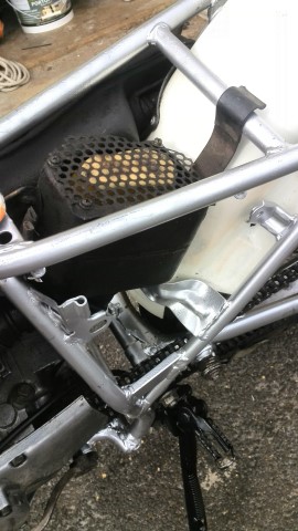

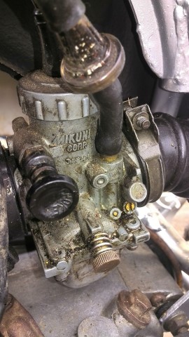

Is the dodgey air filter cover gonna do the job or should I be replacing it?

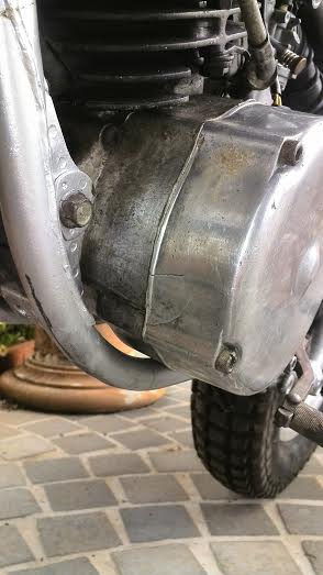

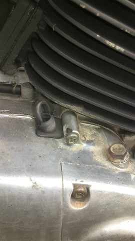

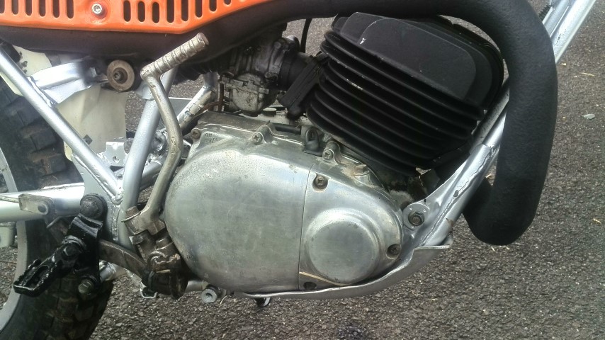

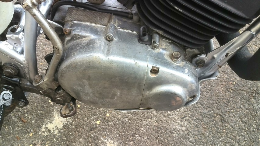

Also a few more closer photos including one of a chunk of metal missing out of the crank case cover, and a few cracks - are these any cause for concern ?

crack in the flywheel cover - not important for strength, but seal it so it keeps out most of the dust and water. It's a good idea to loosen that cover off and let it dry out after you wash the bike or ride in the wet. The cracks can be welded if you want
crack in the screw boss on the clutch cover - not important
mesh lid on air filter - fine as long as the filter can't come loose while you are riding
