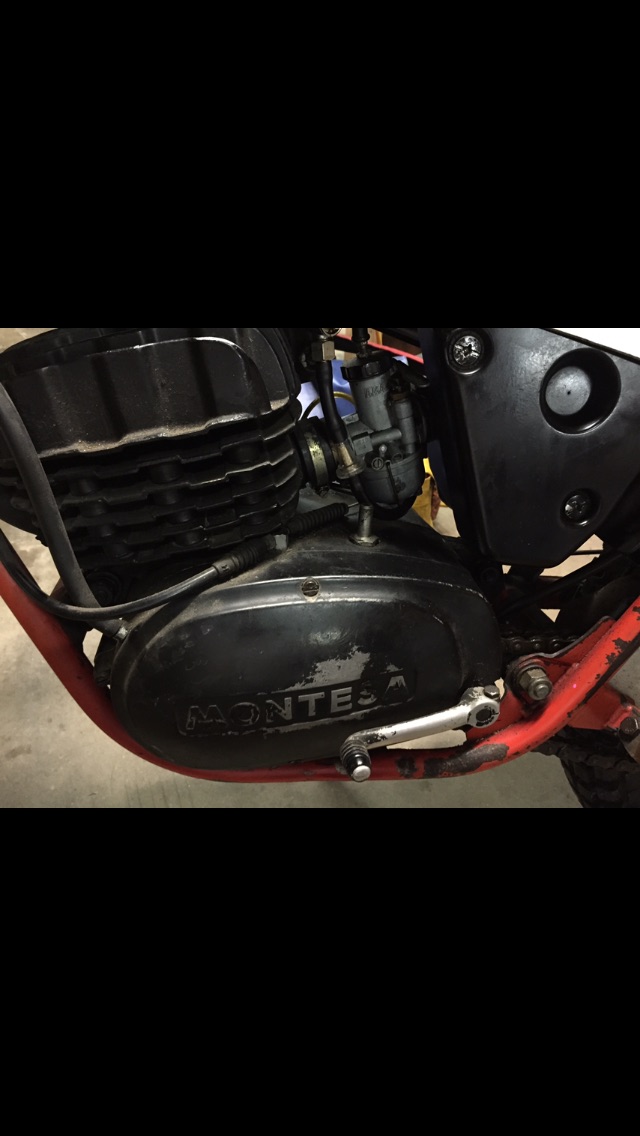

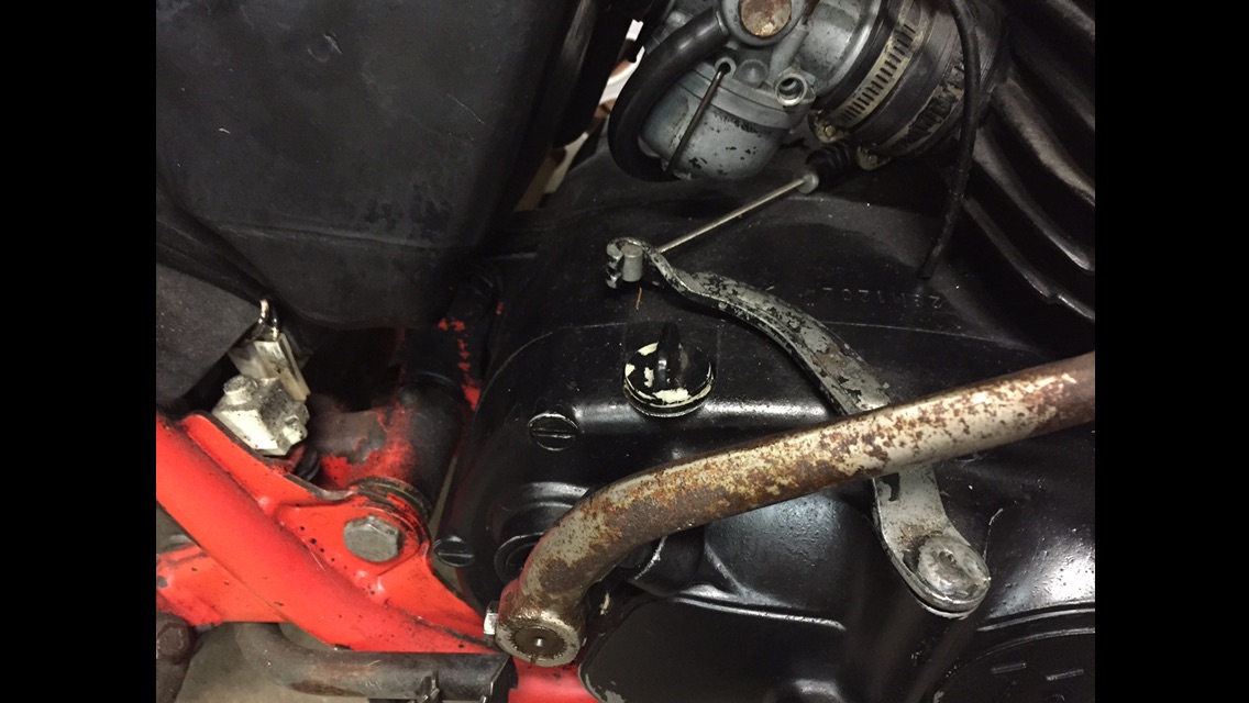

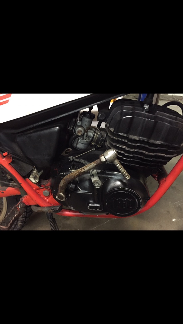

Have included some pics, I can only locate one Oil Fill Point, but I am an Electrician not a Mechanic.
Will try and track down King Scorpion.

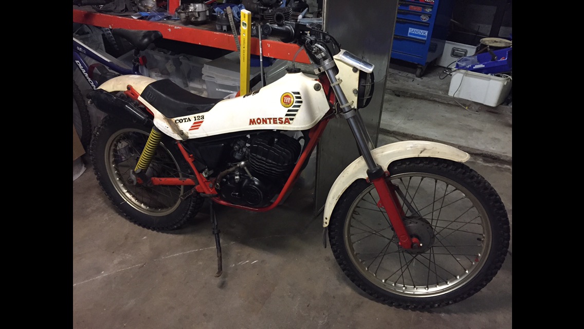

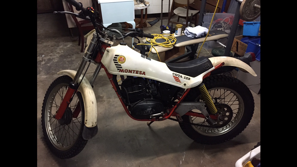

Pics of the bike as promised
