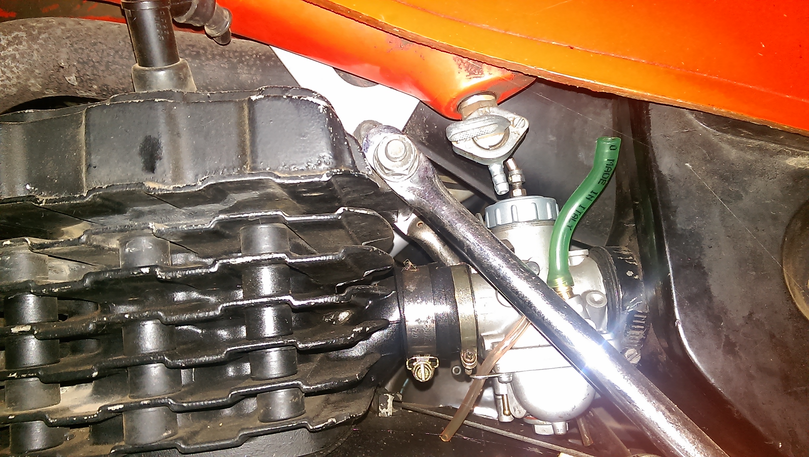

David Lahey wrote:Is there something special about that fuel tap? All the spanish fibreglass tanks I have use 12mm female thread in the tank and taps for these are readily available. One local supplier would be Bultaco Parts Australia http://www.bultacoaustralia.com
Another would be Don Newell in Brisbane
There is a difference. The outlet comes out the side pointing to the rear, not the bottom, in order to avoid the engine brace. Zoom in on the photo. Fuel line not fitted.
Re: Montesa 349 Project
For what it is worth, here is what one of those taps looks like on a 348. The hose does run close to the brace. Not had a problem with it yet

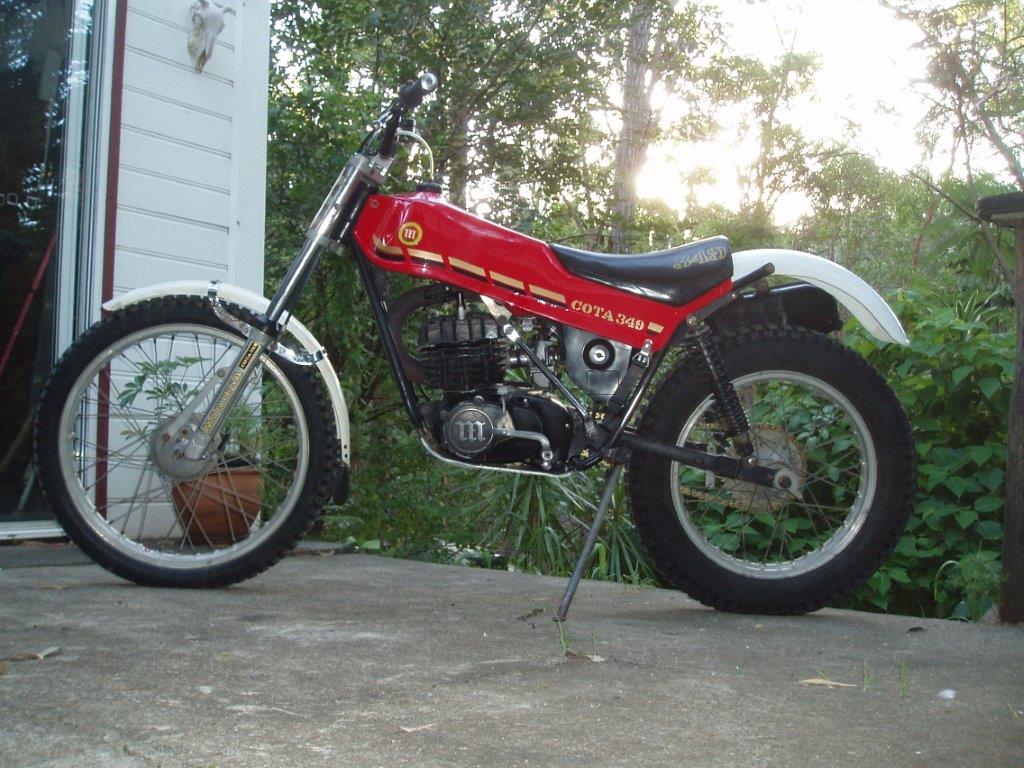

Billy or maybe just measure the clearence between the casing and gear lever at the gear lever shaft on your 349 montesa cota which by the way looks nice. and is yours a 1979 or 1980? The year should be stamped on the rims.
billy
Posts: 39
Bike: muchos motos
Re: My Montesa 349 Project
Post by billy »
Kombivan wrote:Billy or maybe just measure the clearence between the casing and gear lever at the gear lever shaft on your 349 montesa cota which by the way looks nice. and is yours a 1979 or 1980? The year should be stamped on the rims.
The clearance from the inside edge of the gear lever at the gear lever shaft to the casing is 9mm.
The distance from the gear lever to the casing adjacent to the ring around the M is 5.5mm.
I only inscription on the rim that resembles a date is "T-1-80". Is that a date? I wouldn't have thought to look at the rim for ID. I've never been able to find any information that distinguishes between a '79 or '80 based on the engine number.
