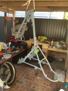

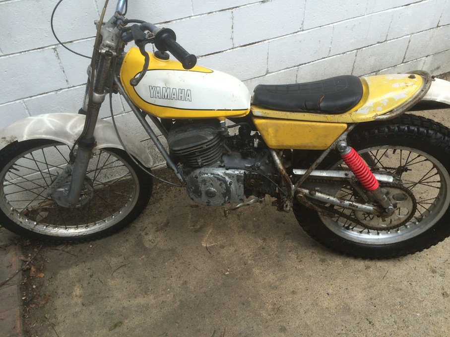

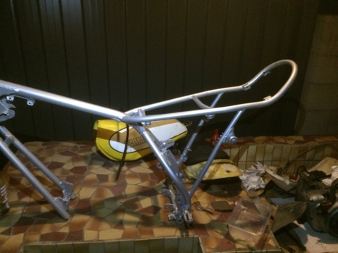

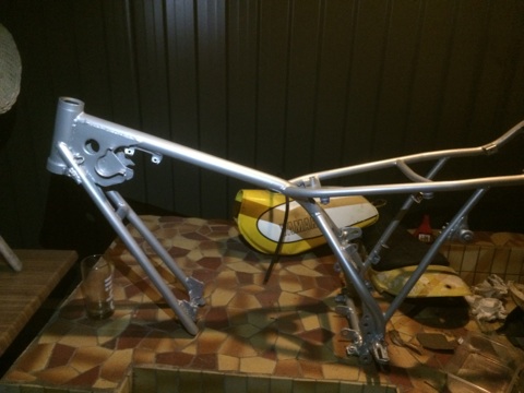

Thought I would post some photos of my ty250 project. Have currently dismantled everything and stripped the frame. The frame is now finished with primer colour and clear coat. Im looking forward to painting the tank and cleaning the rest of the bike up.
Need help with a few items though...

A few question come to mind when I look at the picture of your frame:
The " bridge " that start at the back of the tool box as been cut, do you know if it's been done lately or it's been like that for a while ? Is the frame still strait ?
There is no gousset between the spot where the top of shock bolt to the frame and the top of the frame ( under the seat ) is the down tube still strait ? Maybe it is because of the way the bracket is welded to the tube.

Thanks Guy I didn't notice the missing frame element in that frame until you posted that.
It looks a lot like the Peter Paice Replica TY250 frame I did a few years ago, except the rear uprights have been shortened at their top ends instead of their bottom ends. Cant tell in those photos if the motor has been raised, but it is likely because why else would anyone remove the "toolbox" frame element?
tjay7 do you have any "before" photos of the assembled bike, showing the RH side of the bike?

David, I would say that the motor hasn't been raised,it looks standard height to me. The upper rear shock mounts have been moved down a long way,further than a Majesty by the look of it and there is no stiffening triangle as per the Majesty. I can't see much point in cutting out the toolbox section like that,wonder what the reason was ?

One last thing. Maybe it is the angle that the complete bike picture was taken but the steering angle look steeper than stock to me.
